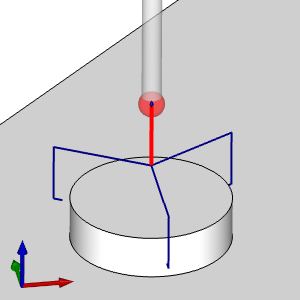

This cycle measures a cylinder extruded in the Z Axis with 3 points. This cycle can utilize the following geometry inputs:
  • An arc whose normal is parallel to the Z Axis.
  • A cylindrical surface edge whose normal is parallel to the Z Axis.
  • A cylindrical surface whose normal is parallel to the Z Axis.

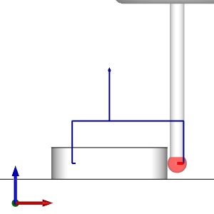

Note: The probe lifts between measurements and the touch points move in towards each other along the specified angles as this cycle is meant to measure extrusions.

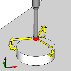

  • Z Measurement Height - determines the end point for the cycle along the Z-axis of the current Work Offset.

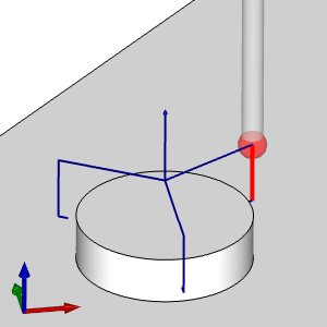

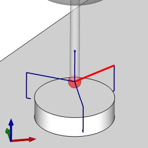

  • First Angle - defines the direction of the first touch point with the X positive direction at 0°.
  • Second Angle - defines the direction of the second touch point with the X positive direction at 0°.
  • Third Angle - defines the direction of the third touch point with the X positive direction at 0°.
  • Diameter - determines the width between surface contact points.

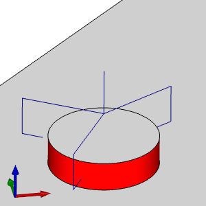

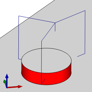

In this case, the geometry we have chosen could be interpreted as a Boss (4 point) cycle. Since this is not the cycle we intended to use, we will need to update the currently selected cycle.
  1. At the top of the Cycles section click the drop down list and select Boss (3 point) from the list.
  1. In the Initial Position group, update the Z value to 0.375, and press Tab.
The Parameters section for this cycle consists of the Z Measurement Height, the angles on which the contact points will extend, the Diameter and the Update Work Offset value. In this case we do not really need to adjust the height at which the probe will make contact. The diameter is automatic and should not need to be adjusted, and the Update Work Offset value can be used as needed. In this part, let's just take a look at adjusting some of the angles.

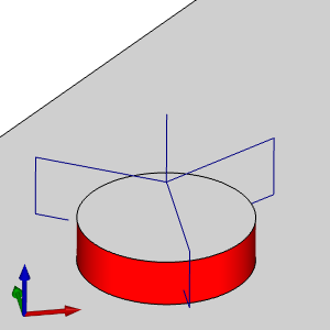

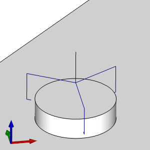

  1. In the Parameters section, update the Third Angle value to 170 and pressing tab.
    The angle is updated, and we now have each contact point separated equally around the boss.

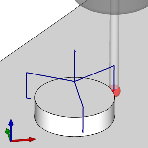

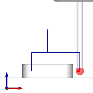

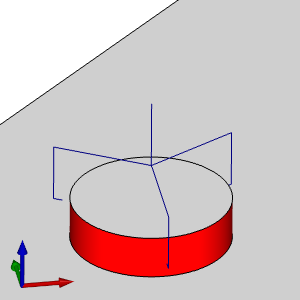

    The Backplot dialog launches.
  3. Notice we seem to have cleared the surface with our probe. Click Next until contact is made with the surface.
  4. Click Close.
