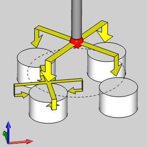

This cycle measures, with 3 points each, a radial pattern of cylindrical extrusions which have been extruded along the Z Axis. This cycle can utilize the following geometry inputs:
  • All arcs of a circular pattern whose normals are all parallel to the Z Axis.
  • All cylindrical surface edges of a circular pattern whose normals are all parallel to the Z Axis.
  • All cylindrical surfaces of a circular pattern whose normals are all parallel to the Z Axis.

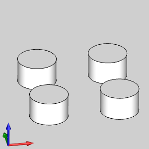

In this example we:
  • Select the Probe feature.
  • Select the cycle.
  • Utilize the Options page.
  • Backplot the result.

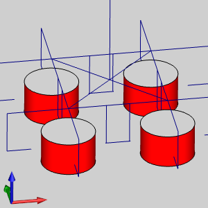

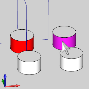

  1. Click the Parameters tab.

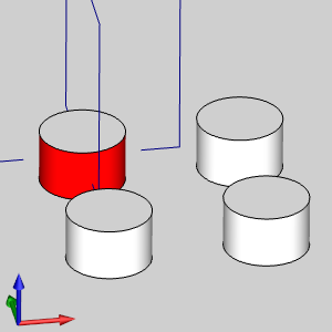

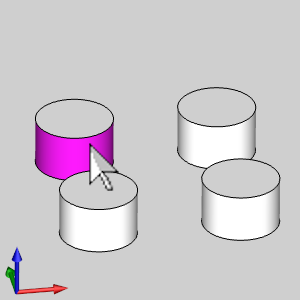

  2. Select one of the cylindrical surfaces which has been extruded along the Z Axis, or the edge of that surface.
  3. Select another of the cylindrical surfaces.
    The geometry is added to the Selected Geometry list, and toolpath appears on the selected cylinder.

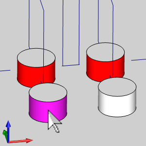

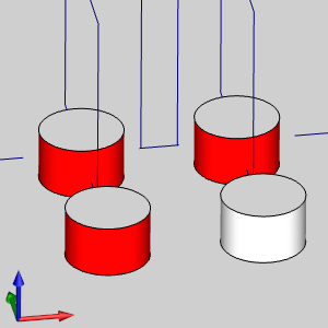

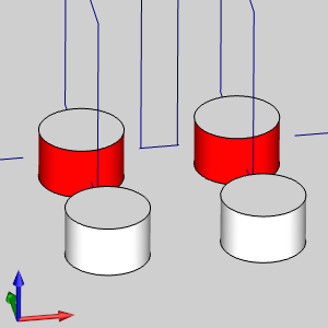

  4. Select another of the cylindrical surfaces.
    The geometry is added to the Selected Geometry list, but notice toolpath doesn't appear on this cylinder.
    Since this cycle is for radial patterns, and since this new geometry does not fit into a radial pattern with the other two, it is left without toolpath.

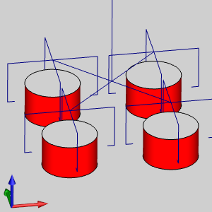

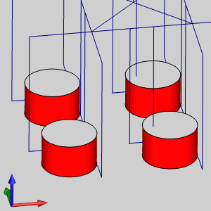

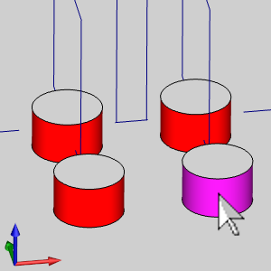

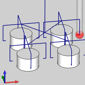

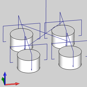

  5. Select the last of the cylindrical surfaces.
    The geometry is added to the Selected Geometry list, and toolpath appears on this, as well as the last, cylinder.
    Since the third, and now fourth cylinder fit into the radial pattern of the first two, all toolpath is now added.

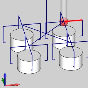

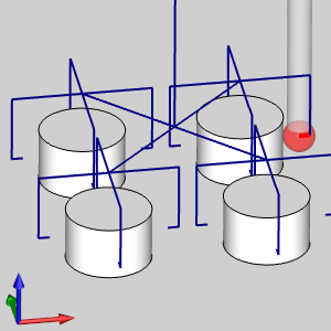

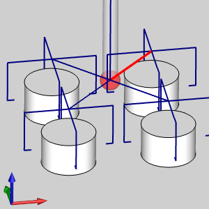

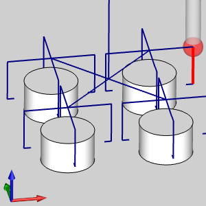

  1. Click the Options tab.

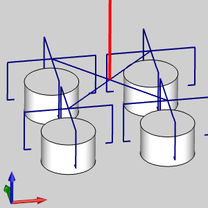

    The Backplot dialog launches.
  3. Notice we seem to have cleared the surface with our probe. Click Next until contact is made with the surface.
Tip: Using a Top View can help you ascertain the clearance of the probe easier.
