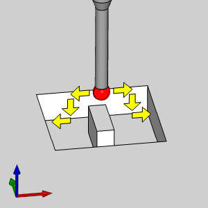

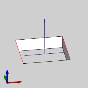

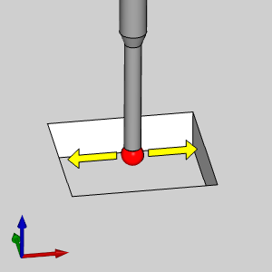

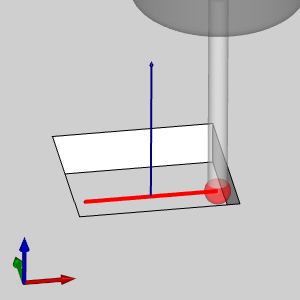

This cycle measures the distance between two planar surface faces which are either both parallel to the X Axis, or both parallel to the Y Axis. This cycle can utilize the following geometry inputs:
  • Two lines which are both parallel to the X Axis.
  • Two planar surface edges which are both parallel to the X Axis.
  • Two lines which are both parallel to the Y Axis.
  • Two planar surface edges which are both parallel to the Y Axis.
  • Two planar surfaces whose normals are both parallel to the X Axis.
  • Two planar surfaces whose normals are both parallel to the Y Axis.
Note: The probe can be made to lift between measurements to avoid obstacles The touch points move away from each other in the X or Y Axis as it is meant to measure pockets.

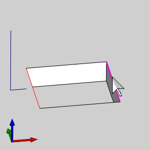

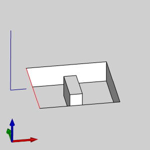

  1. Click the Parameters tab.

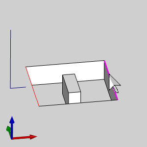

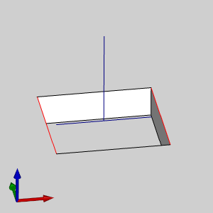

  2. Select the edge of the planar surface whose normal is parallel with X.
    Since our current geometry works for a X Single Surface cycle, that is the cycle that is currently selected for us.
  3. Select the edge of the parallel surface.
Part 5) Updating the cycle

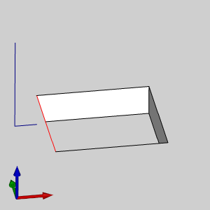

In this case, the geometry we have chosen could be interpreted as a Web cycle. Had we chosen the planar surfaces themselves instead of the edges, the proper cycle would be selected already. However, since we did not, we will need to update the currently selected cycle.

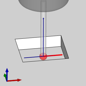

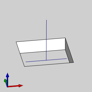

  1. At the top of the Cycles section click the drop down list and select Pocket from the list.

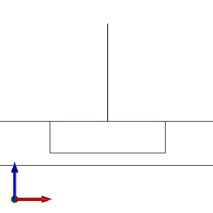

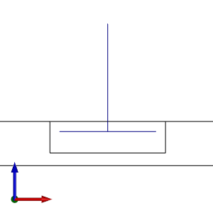

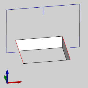

Note: Since our moves are in the X Axis for the surfaces we have chosen, we can adjust our Initial Position in the Y axis.
  1. In the Initial Position group, update the Y value by adding -0.25 to the end, and pressing Tab.
The Parameters section for this cycle consists of the Z Measurement Height, the Pocket Width and the Update Work Offset value. In this case we only want to adjust the height at which the probe will make contact. The Pocket Width is automatic and should not need to be adjusted, and the Update Work Offset value can be used as needed.
  1. In the Parameters section, update the Z value by adding -0.125 to the value and pressing tab.
    The toolpath is Z value is updated, and in a side view we can see the toolpath has updated to reflect the height at which the probe will make contact.

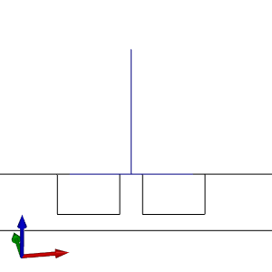

Example 2 - Pocket with Web
In this example we:
  • Select the Probe feature.
  • Select the cycle.
  • Update the cycle.
  • Update the Options section.
  • Utilize the Options page.
  • Backplot the result.
Part 2) Selecting the Probe
Part 4) Selecting the Cycle

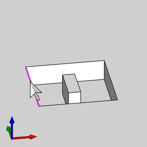

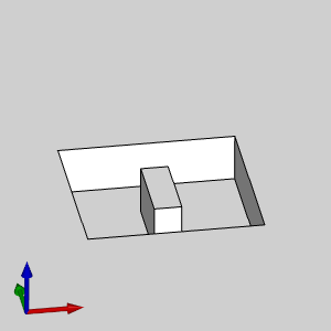

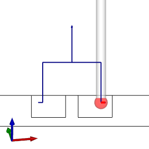

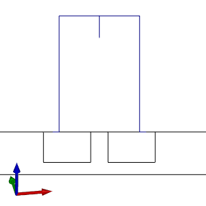

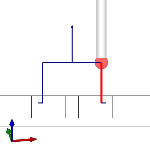

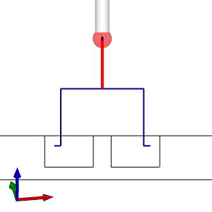

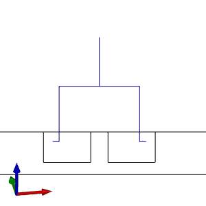

The Options section for this cycle consists of the Radial Clearance value only. Selecting this check box will update the moves to first avoid an obstacle before dropping down. The value will allow you to set how close to the surfaces to move before dropping down to the contact depth.
Part 7) Adjusting the Initial Position
  1. In the Initial Position group, update the Z value to 0.3.75, and press Tab.
    The value and the toolpath update to put the moves out from the initial position closer to the part in Z.
Part 8) Updating the Parameters section

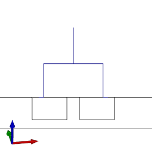

In this case the only parameter we will be updating is the height at which the probe makes contact. We will adjust it so that we make contact one eighth of an inch below the top edge of the pocket.
  1. In the Parameters section, update the Z Measurement Height value by adding -0.125 to the value and pressing tab.
    The toolpath is Z value is updated, and we can see the toolpath has updated to reflect the height at which the probe will make contact.

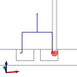

  1. Click the Options tab.
  2. Click Next four times to view the probe movements.
