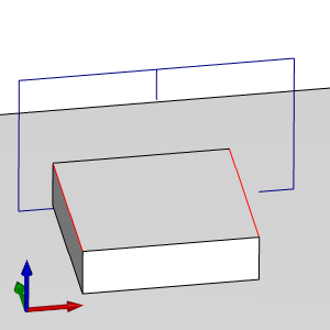

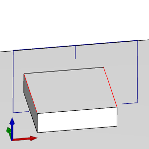

This cycle measures the distance between two planar surface faces which are either both parallel to the X Axis, or both parallel to the Y Axis. This cycle can utilize the following geometry inputs:
  • Two lines which are both parallel to the X Axis.
  • Two planar surface edges which are both parallel to the X Axis.
  • Two lines which are both parallel to the Y Axis.
  • Two planar surface edges which are both parallel to the Y Axis.
  • Two planar surfaces whose normals are both parallel to the X Axis.
  • Two planar surfaces whose normals are both parallel to the Y Axis.

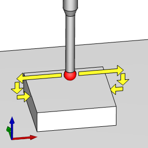

Note: The probe lifts between measurements and the touch points move in towards each other in the X or Y Axis as this cycle is meant to measure extrusions.

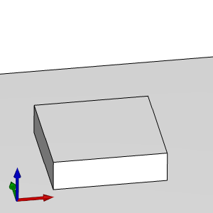

Part 2) Selecting the Probe
Part 4) Selecting the Cycle

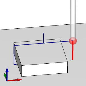

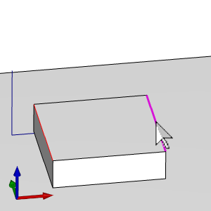

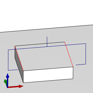

Note: The Web measure cycle measures the distance between two parallel surfaces that are both either parallel with the Y Axis, or the X Axis. In this case we measure two surfaces parallel with the Y Axis.
  1. Click the Parameters tab.

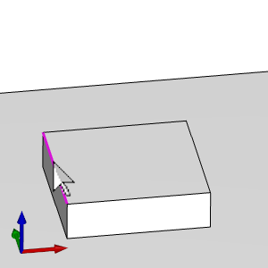

  2. Select the edge of the planar surface whose normal is parallel with X.
    Since our current geometry works for a X Single Surface cycle, that is the cycle that is currently selected for us.
  3. Select the edge of the parallel surface.

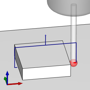

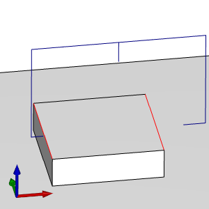

  3. In the Initial Position group, update the Y value by adding -0.5 to the end, and pressing Tab.
Note: Since our moves are in the X Axis for the surfaces we have chosen, we can adjust our Initial Position in the Y axis.

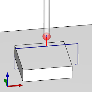

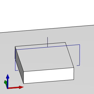

  1. In the Initial Position group, update the Z value to 0.675, and press Tab.
  1. Click the Options tab.

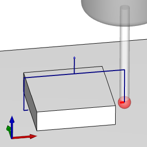

    The Backplot dialog launches.
  3. Notice we seem to have cleared the surface with our probe. Click Next until contact is made with the surface.
  4. Click Close.
