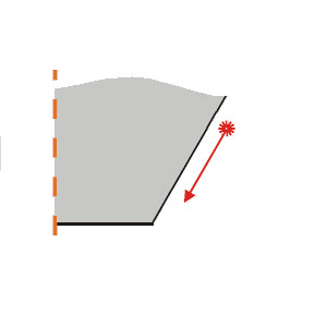

This cycle is used to verify the specified form of a linearly profiled cutting tool.

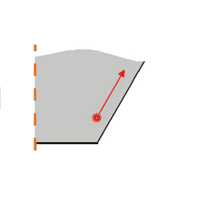

The specified form of the profile can be checked either internally, for the detection of missing or broken teeth and inserts; or externally, for detection of misaligned inserts and incorrect forms.
The tool is retracted to the home position for safety before each profile check unless a secondary profile check is to be performed on the same tool. The tool is positioned over the laser beam and is moved first to the longest tool position, then to the profile start position with the spindle rotating. The defined cutter profile is traced at the checking feedrate. Finally, the tool is retracted out of the beam.
An error flag is always set and an alarm is optionally generated if the cutter is out of tolerance.
If both + and – tolerance checking is specified, the cutter is repositioned after the negative (–) tolerance check and a reverse profile check is made along the profile. Finally, the tool is retracted.

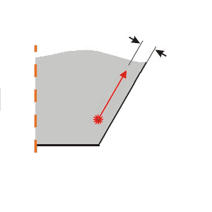

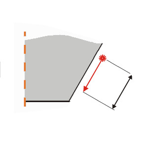

  • Linear Distance - determines the tangential distance beyond the cutter profile to measure.

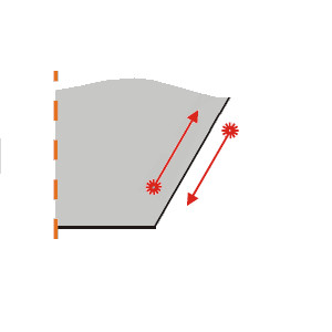

  • Check Cutter Profile Option - determines which side the tool is measured on and whether a retract is used. Choose between:
    • Along the Negative - measures the tool along a negative offset of the tool profile based on the specified tolerance.
    • Along the Positive - measures the tool along a positive offset of the tool profile based on the specified tolerance.
    • Both - measures the tool along offsets of the tool profile based on the specified tolerance.
    • Along the Negative (No Retract) - measures the tool along a negative offset of the tool profile based on the specified tolerance. The tool does not retract after the profile check.
    • Along the Positive (No Retract) - measures the tool along a positive offset of the tool profile based on the specified tolerance. The tool does not retract after the profile check.
    • Both (No Retract) - measures the tool along offsets of the tool profile based on the specified tolerance. The tool does not retract after the profile check.

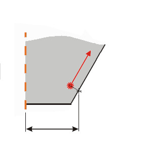

  • Radial Distance - Radial distance to the cutter radius center.

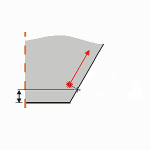

  • Check Height - The height to the first profile checking position.

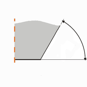

  • Angle - determines the angle at which the linear profile will be measured.

Part 4) Setting the Linear Distance
  1. In the Linear Distance text box, set the distance to be measured.

  1. In the Options section, select the check box for Radial Distance.
  2. In the Radial Distance text box, set the distance from the spindle axis to begin the measurement.
  3. In the Options section, select the check box for Check Height.
  4. In the Check Height text box, set the distance from the tool tip the measurement should begin.
  5. In the Options section, select the check box for Angle.
  6. In the Angle text box, set the angle to measured.
