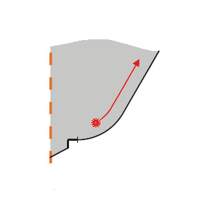

This cycle is used to verify the specified form of a profiled cutting tool. It is particularly suitable for ball nose cutters, and cutters with a corner radius.

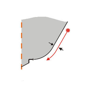

The specified form of the profile can be checked either internally, for the detection of missing or broken teeth and inserts; or externally, for detection of misaligned inserts and incorrect forms.
The tool is retracted to the home position for safety before each profile check unless a secondary profile check is to be performed on the same tool. The tool is positioned over the laser beam and is moved first to the longest tool position, then to the profile start position with the spindle rotating. The defined cutter profile is traced at the checking feedrate. Finally, the tool is retracted out of the beam.
An error flag is always set and an alarm is optionally generated if the cutter is out of tolerance.
If both + and – tolerance checking is specified, the cutter is repositioned after the negative (–) tolerance check and a reverse profile check is made along the profile. Finally, the tool is retracted.

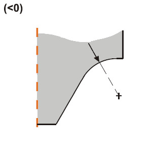

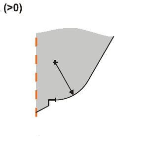

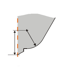

  • Profile Radius - determines the radius to measure. Use a positive value for a convex radius and a negative value for a concave radius.
Positive Radius Negative Radius

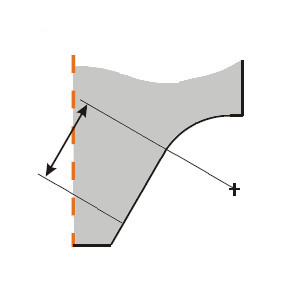

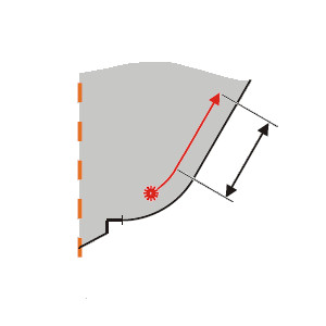

  • Linear Distance - determines the tangential distance beyond the cutter profile to measure.

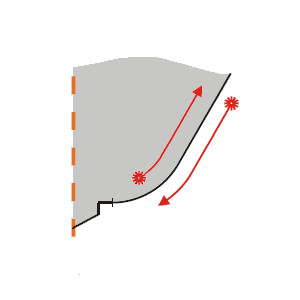

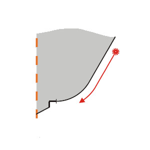

  • Check Cutter Profile Option - determines which side the tool is measured on and whether a retract is used. Choose between:
    • Along the Negative - measures the tool along a negative offset of the tool profile based on the specified tolerance.
    • Along the Positive - measures the tool along a positive offset of the tool profile based on the specified tolerance.
    • Both - measures the tool along offsets of the tool profile based on the specified tolerance.
    • Along the Negative (No Retract) - measures the tool along a negative offset of the tool profile based on the specified tolerance. The tool does not retract after the profile check.
    • Along the Positive (No Retract) - measures the tool along a positive offset of the tool profile based on the specified tolerance. The tool does not retract after the profile check.
    • Both (No Retract) - measures the tool along offsets of the tool profile based on the specified tolerance. The tool does not retract after the profile check.

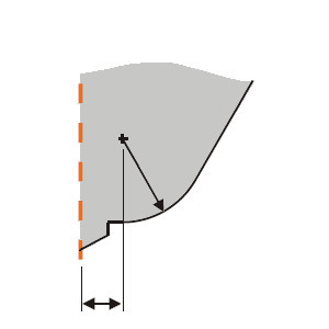

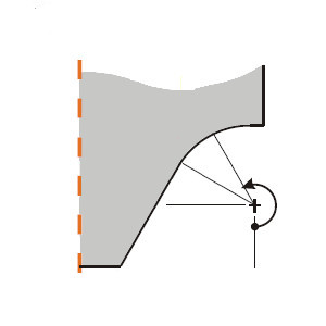

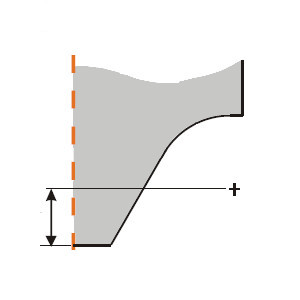

  • Radial Distance - Radial distance to the cutter radius center.
  • Safety Plane - The distance along the spindle-axis by which the tool is retracted from the beam.
  • Number of Flutes - sets the number of flutes to determine at which spindle speed the cycle should be run.
  • Check Height - The height to the first profile checking position.

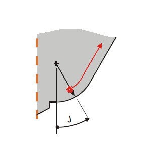

  • Start Angle - The point on the radius in relation to its center at which profile checking begins.
  • End Angle - The angle, in relation to the start angle, at which the radius of the cutter terminates.

The Radius Profile Checking cycle is designed to verify the shape of the tool is still true to the specification.Because of this, exact figures must be known so they can be entered accurately in the option values of the cycle. Having a drawing of the tool profile to check the proper values is extremely helpful for this cycle. It is also important to know which value to use for the described radius. While using a positive radius will describe a radius as is found in a ball endmill, using a negative value will describe a concave radius as found in a corner round tool. In this case we will be describing a negative radius.

  3. Set the Tool Diameter value to the radius being checked.
    Since our tool has a concave radius, we use a negative value.
Part 4) Setting the Linear Distance
  1. In the Linear Distance text box, set the distance to be measured past the radius of the tool.

  1. In the Options section, select the check box for Radial Distance.
  2. In the Radial Distance text box, set the distance from the radius center to the spindle axis.
  3. In the Options section, select the check box for Check Height.
  4. In the Check Height text box, set the distance from the radius center to the tool tip.
  5. In the Options section, select the check box for Start Angle.
  6. In the Start Angle text box, set the angle to begin measurement of the described radius.
  7. In the Options section, select the check box for End Angle.
  8. In the End Angle text box, set the angle at which the radius terminates.
