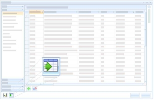

Tool Library Interface
Tool Panel Bar
The left-most portion of the Tool Library is the Tool Panel Bar which groups the tools. The tool are divided first by Drill, Mill, Lathe, Laser, Plasma, and Waterjet. Clicking on a particular group will display the available tool types in that group. Finally, clicking on a particular tool type will show all the tools available tools of that type.
Tool Grid View
With a particular tool type selected, the Tool Grid View will show all the available tools of that type. From this point you can add tools, or highlight a particular tool to delete it.
Tool Parameter Grid Splitter
Upon opening the Tool Library, the Tool Parameter Dialog will be collapsed. To expand the Tool Parameter Dialog, click the chevron icon. With the Tool Parameter Dialog expanded, click the chevron icon to collapse it. The Tool Parameter Grid Splitter can also be used to resize the Tool Parameter Dialog. Hover over the left side of the Tool Parameter Grid Splitter until the mouse icon displays as the double headed arrow. You can then hold left-click and drag the dialog to the desired size.

Importing a Library
To use an existing library:
  1. Click the Import from file button on the bottom left.
    The Open dialog appears.
  2. Locate and highlight the appropriate file.
  3. Click Open.
    The library is updated based on the imported file.
