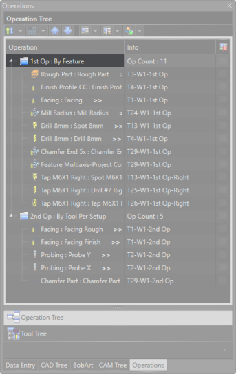

The Operation Tree has now been updated to maintain custom ordering. Previously, when the order of your CAM Tree was modified, or operations were added, we would attempt to maintain the intended customization, while also maintaining the selected machining order. In this update, each job will list the selected machining order, whether it be By Feature, By Tool Per Setup, By Tool, or Custom Order. When a Custom Order has been set, it will be maintained regardless of how the CAM Tree is updated. New Operations are added to the bottom of the Operation Tree and can then be moved into the desired position by the user. In this way, when you take the time to manually adjust your Operation Tree, it will not be changed, unless you select another Machining Order option.
Select Machining Order | Lists Machining Order | Shows Custom Order |
