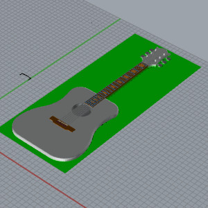

In this example, an acoustic guitar has already been created, and three features remain that are created using solid entities. The current condition of the model is shown next.

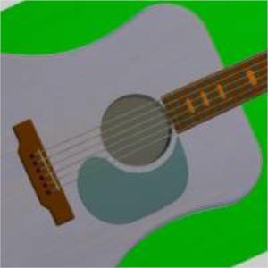

    Inmimg
Notice, as shown in the second image, the feature is being added to the strings. This is the result of the Add application type. The cover needs added to the head stock but not the strings. For this, we change the application type and adjust the Z-height of the solid.
