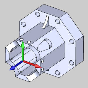

In the example file provided, the Tool Crib is already equipped with the necessary tools and the stock and Machine Setup are already defined. The part is simulated using the BC_Hermie_C20U machine.
Part 1) Add the Feature

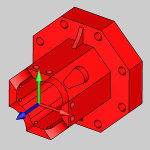

  3. Select the model.

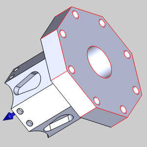

  5. In the Geometry input group, click the ellipses button next to Exclude Edges.

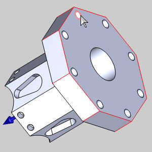

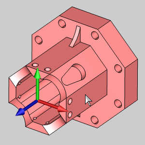

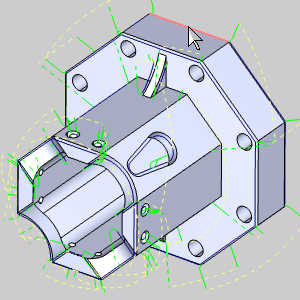

  6. Hover over the back edge as seen in the image below.
  7. Select the edge along the outer diameter of the part as seen in the image below.
  8. Repeat this for the remaining edges.

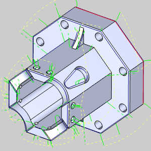

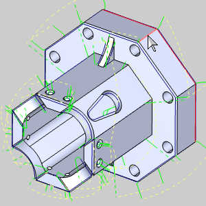

  9. Rotate the part and select the edges on the back.
    With these edge selected, we will avoid the cutting the jaws holding the part in place.
  10. Click OK.
  11. In the Surface Quality group, set the Cut tolerance to 0.001.

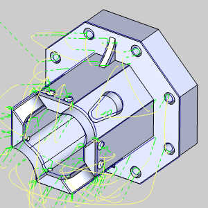

  1. Click the Link tab to move to that page.
  2. In the Clearance area group, set the Type to Automatic.
  3. In the Links group, set the Type to Clearance blend spline.
  4. Click Compute.

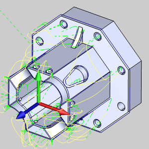

  5. Click Play to view the current operation.
    Notice the crash.
    We will need to adjust the allowable angle of tool to correct this.

    Notice the slight tilt of the toolpath now.
Part 10) Simulation
    Notice the part is now cut without collision.
