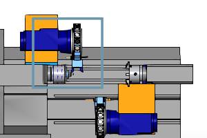

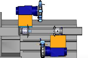

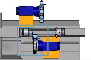

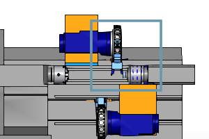

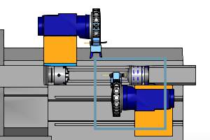

BC 2T 2S Mill Turn Machine
BC 2T 2S Submachine Naming
UT_MS= Upper Turret, Main Spindle
UT_SS= Upper Turret, Sub Spindle
LT_MS= Lower Turret, Main Spindle
LT_SS= Lower Turret, Sub Spindle
