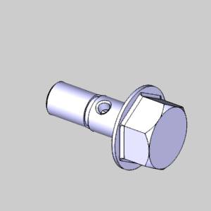

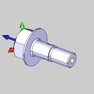

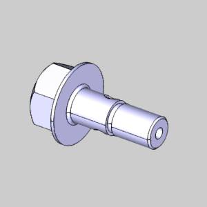

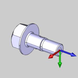

Example Part
The following images show our example part. For this example, we machinethe part using stock that is already cut to length. For this reason, we create our features as though the model is split into two halves: front and back. This allows us to machine the front half of the part on the main spindle before transferring the part to the sub spindle and machiningthe back half. This is important to understand as this determines how we set the needed values.
Machine Setups

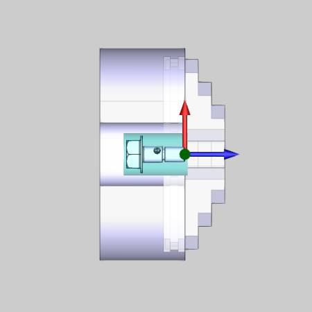

For this example, all features are created using two machinesetups: one for the front side and one for the back side of the part. The following images show the location and orientation of the machiningorigin (work offset) for each setup.

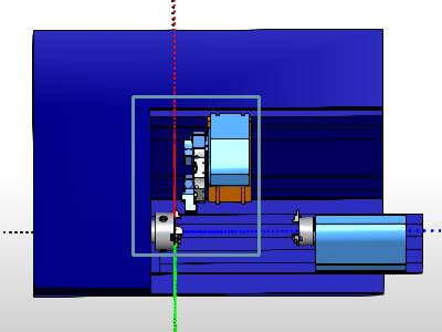

Machine Setup1 (UT_MS)

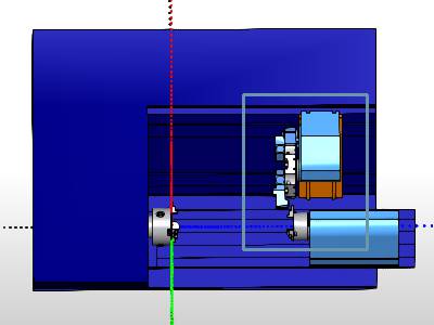

Machine Setup2 (UT_SS)

Part 1) Update Work Offset Values: Machine Setup - 1
When simulating your machine, it is important to have the proper work offset values. In a Mill Turn job, whether you are working on the main spindle, or the subspindle, the machine setups are placed at the center of the appropriate spindle chuck face. The Work Offset values allow you to compensate for this by specifying the values to offset the position of the machine setup by. First we simulate to note the current state, and then alter the Work Offset values for the first Work Offset.

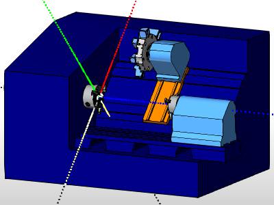

  1. In the CAM Tree Manager, right-click Mill Turn Job, and select Simulation.
    The Simulation launches.
  2. Notice the stock, and associated toolpath, are all inside of the main spindle.
    This is because of the default Work Offset Z value of zero lining our Machine Setup with the center of the chuck face.

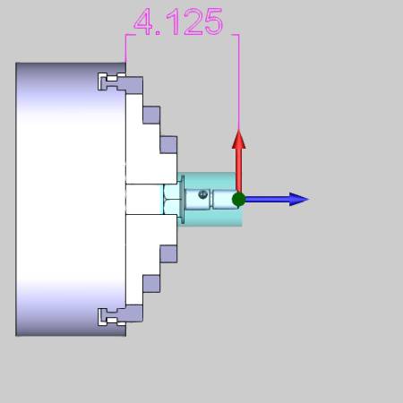

Edit the Work Offset Z value
  1. Right-click on Machine Setup - 1 and choose Edit.
    The Machine Setup dialog opens in the Data Entry Manager.
  2. At the bottom of the Machine Setup dialog, click Work Offset.
    The Work Offset dialog opens.
  3. Set the Z value to 4.125.
    This positions the machine setup, and therefore the part and the stock, as shown in the image below.
    This should give us sufficient material to hold on to, while exposing enough material to complete the work on the first setup without contacting the chuck jaws.

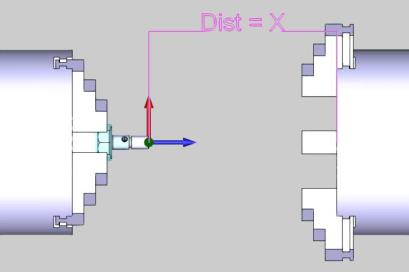

Tip: It can be helpful to draw a quick sketch of the jaws being used in the chuck to determine how far out to position the machine setup from the spindle chuck face. This is shown in the image below. To find out more about defining chucks and chuck jaws, see The Chuck Configuration Dialog topic.

  3. Set the Z value to 2.875.
    Again, this specifies the distance the Machine Setup should be offset from the spindle chuck face.
Work Offset value: 0.00 Work Offset value: 2.875

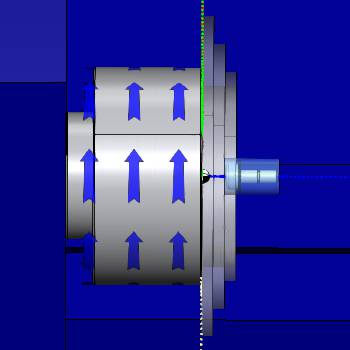

Edit the Work Offset Spindle Park Position value
If, in the first step of this example, you played through the simulation, you may have noticed the work being done on the second setup was being done with the two spindle faces pressed against each other. This is because the Spindle Park Position was still set to zero. In the Spindle Park Position, specify a distance from the face of the main chuck, at which the work on the second spindle should be completed.
  1. Set the Spindle Park Position to 20.00.
  2. Click OK.
    The Work Offset dialog closes.
  3. At the bottom of the Machine Setup dialog, click OK.
    The Machine Setup dialog closes.

    Notice the position of the part in the main spindle:
  4. In the Move List, click Op.10: "Lathe Thread-60 DEG - LAY DOWN".
    The simulation jumps to this operation.
  5. Set the Simulation Run Speed slider to about 25%, (with 0% being all the way to the left).
  6. Click Run.
    The Threading operation is completed, and the stock jumps to the subspindle.
    Notice the stock position in the subspindle.
Note: You may also notice, the work being done is now well away from the main spindle. This is due to the value we used in the Spindle Park Position in the second machine setup.

The values used in the commands of the part transfer are based on the values assigned to the subspindle in the Work Offset dialog of the first machine setup. By setting our Subspindle Z value to match that of the Z value, as we did, we ensure that a zero value will place the face of the subspindle directly on the first machine setup. This means the values mentioned above can all be easily referenced from the first machine setup as seen in the image below:
  1. In the Task List, expand Move Sub Spindle To Clearance.
    Three commands appear.
  2. Click on Axis, and set the Axis Value in the Parameters group to 5.
  3. In the Task List, expand Start Fast Feed Up To Part.
    Four commands appear.
  4. Click on Axis, and set the Axis Value in the Parameters group to 2.
    We use this value because our jaws, in this case, are 1.875 from the face of the spindle.

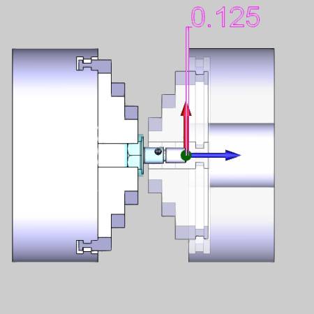

  5. In the Task List, expand Feed To Pickup Location.
  6. Click on Axis, and set the Axis Value in the Parameters group to 0.125.

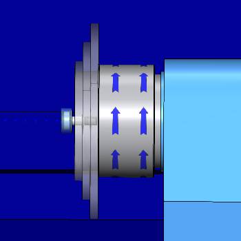

    We only use this value to leave a little space behind the head of the bolt as seen in the image below.
  7. In the Task List, expand Part Transfer.
    A single command appears.
  8. Click on the Part Transfer command, and set the Part Pickup Position in the Parameters group to 0.125 as well.

    Notice the moves that occur after the threading operation.
    These distances should coincide with the values we set for the:
    1. Move Sub Spindle To Clearance: Moves toward the part.
    2. Start Fast Feed Up To Part: Moves closer to the part.
    3. Feed To Pickup Location: Arrives at the pickup location seen in the above image.
    4. Part Transfer: Same position as the Feed To Pickup Location.
  5. When the simulation finishes, set the Workpiece to Hide, and the Stock to Show.
    The stock should appear as our part does in the first images of this example.
