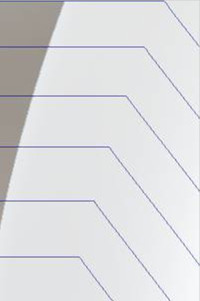

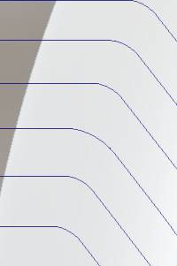

Round Corners
The Round Corners option allows you to specify a maximum deviation value which allows a radius within that range to be substituted in place of sharp corners. To turn this option on, click the Round Corners check box. You can then type the maximum deviation possible for the round corners in the Maximum Deviation box. To turn this option off, clear the Round Corners check box.
Round Corners
Round Corners
