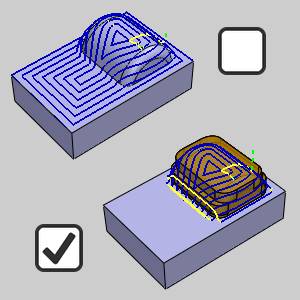

Bounds
The Trim to Stock option provides the ability to pass the stock definition to the toolpath calculation, which trims the toolpath to remove air cutting. You can assign stock geometry (.stl or solid model) to the Operation Stock item in the CAM Tree, or if you do not assign operation stock, the software uses the stock definition from the Stock Wizard. This option can be used as a 3D boundary for the operation.
Important: In order to pass a stock definition to the toolpath calculation, you must turn on Trim to Stock in the wizard as explained next. If you assign Operation Stock, but do not turn on Trim to Stock, the stock isn't used in the toolpath calculation.
  • Trim to Stock
    - Clear the check box to create the operation without trimming the toolpath to the stock.
    - Select the check box when you want the software to trim the toolpath for the operation to the stock in one of two ways. You can (1) assign a solid model or .stl file using the Operation Stock item in the CAM Tree, or (2) if you don't assign operation stock, the software automatically uses the stock from the Stock Wizard to trim the toolpath. View Selecting Operation Stock.
    Trim to Stock
