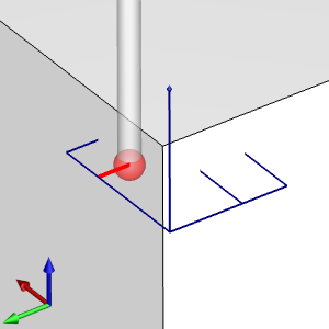

This cycle measures the location of two perpendicular planar surface faces to determine the location of their intersection. This cycle can utilize the following geometry inputs:
- Two perpendicular lines which are aligned along the X and Y Axes.
- Two planar surface edges which are aligned along the X and Y Axes.
- Two planar surfaces whose normals are aligned along the X and Y Axes.

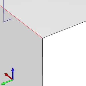

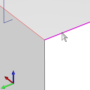

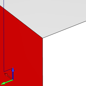

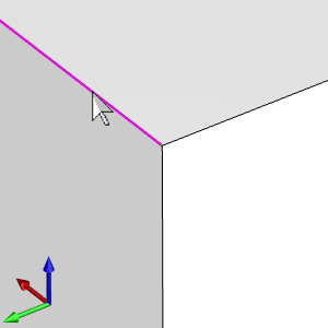

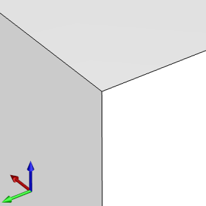

By default the Selected Geometry list is given focus to allow you to select geometry from the graphics area. - Select the edge of the surface whose normal is parallel with the Y Axis.
Since our current geometry works for a X Single Surface cycle, that is the cycle that is currently selected for us. - Select the edge of the surface whose normal is parallel with the X Axis.
Since our current geometry works for an External Corner cycle, that is the cycle that is currently selected for us.

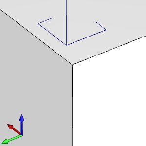

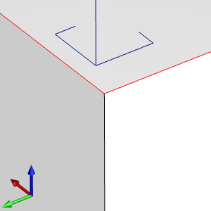

In this case, the geometry we have chosen is interpreted as an External Corner cycle. The probing feature can do quite a bit of intelligent placement of the toolpath based on the surfaces selected. When edges are the only thing used for geometry selection, not as many assumptions can be made for the intelligent placement of the toolpath. We will take a look at how the geometry selection affects the automatic placement of the created toolpath.
- Next to the Selected Geometry list box, click the
Delete All button.

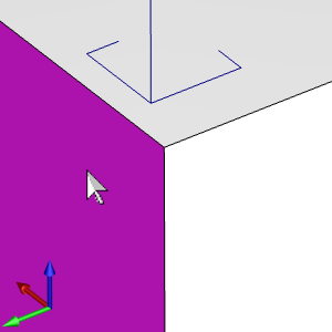

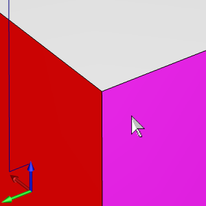

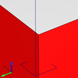

The geometry is removed from the list, and the edges are no longer highlighted. - Select the surface whose normal is along the Y Axis.
The surface is added to the Selected Geometry list, and the toolpath updates once more showing us a X Single Surface cycle. - Select the surface whose normal is along the X Axis.
The surface is added to the Selected Geometry list, and the toolpath updates once more showing us the intended Internal Corner cycle.Notice this time, the cycle is on the correct side of the surface, as well as at the correct height.

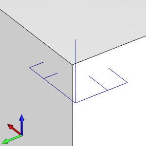

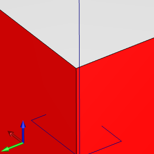

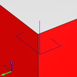

- In the Initial Position group, update the X value by adding -0.25 to the end, and pressing Tab.
The value and the toolpath update to put the initial position of the probe a quarter inch further back in X.

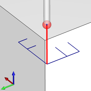

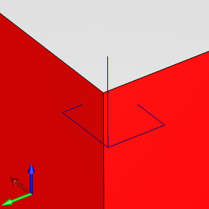

The Parameters section for this cycle consists of the Z Measurement Height, the Corner X and Corner Y values, and the Update Work Offset value. The Corner X and Corner Y values should not need to be adjusted since they are calculated automatically and list the position of the intended corner to be measured. For this example, we will update the Z Measurement Height.
Note: The value of the Z Measurement Height is an incremental height from the Machine Setup. In this case, our Machine Setup is at the top of the part.
- Update the value of the Z Measurement Height to a quarter inch below the top of the part.Since our machine setup is at the top of the part, we update the value to -0.25.
The toolpath is updated.

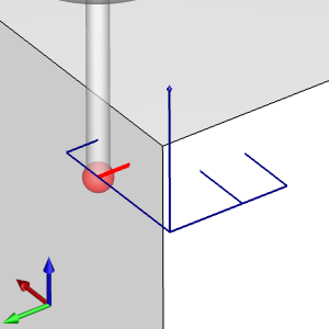

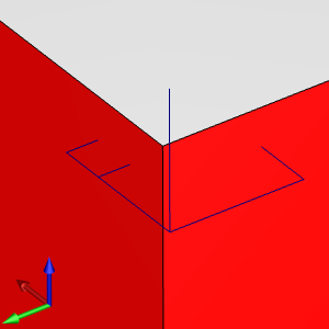

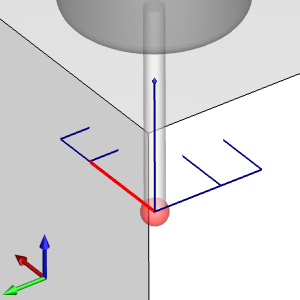

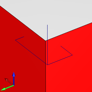

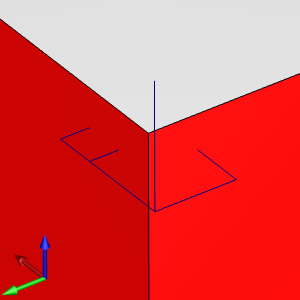

The Options section for this cycle consist of a total of four options: X Distance, Y Distance, X Second Distance, and Y Second Distance. The X/Y Distance options allows you to set a distance from the intended corner at which the contact with the surface will be made. These distances will adjust the contact points without modifying the initial position. The X/Y Second Distance options allow you to create additional contact points on each of the surfaces. These additional contact points allow you to find the corner for surfaces that are not at a ninety degree angle. If both of the second distance options are not used, the corner is assumed to be ninety degrees.

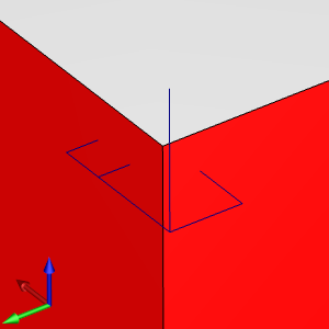

- In the Options section, select the check box for X Distance.
Notice the contact point updates its location along the X Axis without adjusting the initial position. - In the Options section, update the X Distance value to 0.25 and press Tab.
Notice the contact point updates its location along the X Axis without adjusting the initial position. - In the Options section, select the check box for X Second Distance.
Notice a new contact point is created along the X Axis.
Note: While the value of the X,Y Distance options define the distance from the wall, notice the value of the X,Y Second Distance determines the distance between the first and second contact points.

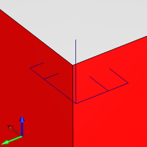

- In the Options section, select the check box for Y Distance.
Notice the contact point updates its location along the Y Axis without adjusting the initial position. - In the Options section, update the Y Distance value to 0.25 and press Tab.
Notice the contact point updates its location along the Y Axis without adjusting the initial position. - In the Options section, select the check box for Y Second Distance.
Notice a new contact point is created along the Y Axis. The corner is no longer assumed to be ninety degrees any longer.

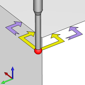

The Backplot dialog launches, and the probe and first move become visible. - Click Next three times to view the probe movements.
- Click Close.
