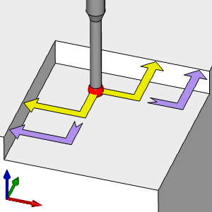

The Internal Corner Cycle
This topic will explain the Internal Corner measure cycle, will describe how to access it, will explain the options found in it, and will explain how to use it with quick steps and an example.

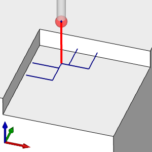

This cycle measures the location of two perpendicular planar surface faces to determine the location of their intersection. This cycle can utilize the following geometry inputs:
- Two perpendicular lines which are aligned along the X and Y Axes.
- Two planar surface edges which are aligned along the X and Y Axes.
- Two planar surfaces whose normals are aligned along the X and Y Axes.

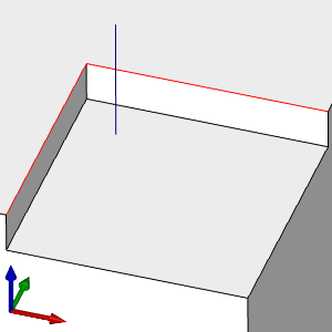

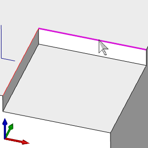

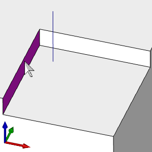

By default the Selected Geometry list is given focus to allow you to select geometry from the graphics area. - Select the edge of the surface whose normal is parallel with the X Axis.
Since our current geometry works for a X Single Surface cycle, that is the cycle that is currently selected for us. - Select the edge of the surface whose normal is parallel with the Y Axis.
Since our current geometry works for an External Corner cycle, that is the cycle that is currently selected for us.
Part 5) Updating the geometry
In this case, the geometry we have chosen could be interpreted as a External Corner cycle.Once we update the cycle, our toolpath will be on the correct side of the corner.The probing feature can do quite a bit of intelligent placement of the toolpath based on the surfaces selected.When edges are the only thing used for geometry selection, not as many assumptions can be made for the intelligent placement of the toolpath.We will take a look at how the geometry selection affects the automatic placement of the created toolpath.
- At the top of the Cycles section click the drop down list and select Internal Corner from the list.

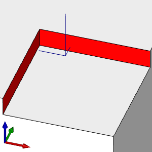

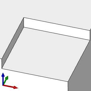

The toolpath and the available Parameters update.However, notice we cannot see the moves that contact the surfaces. This is due to the fact that we have only selected edges. Currently our contact points are inside of the part.Let us take a moment to correct that without having to manually update the necessary values. - Next to the Selected Geometry list box, click the
Delete All button.

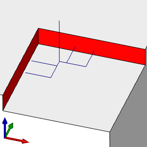

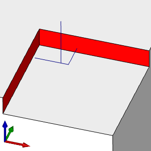

The geometry is removed from the list, and the edges are no longer highlighted. - Select the surface whose normal is along the X Axis.

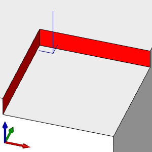

The surface is added to the Selected Geometry list, and the toolpath updates once more showing us a X Single Surface cycle.Notice this time, the cycle is on the correct side of the surface. - Select the surface whose normal is along the Y Axis.
The surface is added to the Selected Geometry list, and the toolpath updates once more showing us the intended Internal Corner cycle.Notice this time, the cycle is on the correct side of the surface, as well as at the correct height.

The Options section for this cycle consist of a total of four options: X Distance, Y Distance, X Second Distance, and Y Second Distance. The X/Y Distance options allows you to set a distance from the intended corner at which the contact with the surface will be made. These distances will adjust the contact points without modifying the initial position. The X/Y Second Distance options allow you to create additional contact points on each of the surfaces. These additional contact points allow you to find the corner for surfaces that are not at a ninety degree angle. If both of the second distance options are not used, the corner is assumed to be ninety degrees.

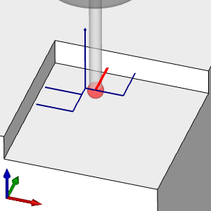

- In the Options section, select the check box for X Distance.
Notice the contact point updates its location along the X Axis without adjusting the initial position. - In the Options section, select the check box for X Second Distance.
Notice a new contact point is created along the X Axis.
Note: While the value of the X,Y Distance options define the distance from the wall, notice the value of the X,Y Second Distance determines the distance between the first and second contact points.

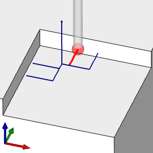

- In the Options section, select the check box for Y Distance.
Notice the contact point updates its location along the Y Axis without adjusting the initial position. - In the Options section, select the check box for Y Distance.
Notice the contact point updates its location along the Y Axis without adjusting the initial position. - In the Options section, select the check box for Y Second Distance.
Notice a new contact point is created along the Y Axis. The corner is no longer assumed to be ninety degrees any longer.

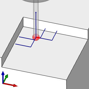

The Backplot dialog launches, and the probe and first move become visible. - Click Next three times to view the probe movements.
