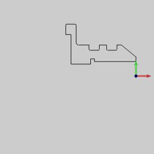

For every turning part that is created, you will need to open or create the lathe part and then create a Turning Job.In this case, we will be opening an existing CAD file to create a Turning Job.
  1. Open the Lathe_Basics_Tutorial.bbcd file.
  2. Click the CAM Tree tab.
  4. Under Job
  5. Type, select Turningand click

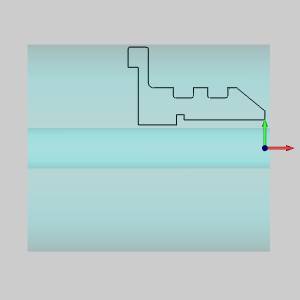

The first page of theStock Wizard allows you to define a Workpiece for the Turning Job and the subsequent pages handle shape, size and clearances. In this example, we will not define a Workpiece, but will define the shape, size and clearances for our stock.Once the stock has been defined you can adjust the visibility of the stock.
  2. In the Stock Type page, leave the selection on Cylindricalof the Coordinate System.
  3. In the Size group, type in the following values:
    1. Stock Diameter = 5.125
    2. Internal Diameter = 1.000
    3. Length = 6.000
    4. Stock Origin = 0.125
  4. Click .
  5. Leave the Clearance values as they are and click OKto finalize the stock and exit the wizard.
  6. In the CAM Tree tab in the BobCAM  CAM Tree, right-click Stockand select either Transparencyor Blank.These choices will allow you to, either adjust the transparency of the stock or blank it out completely.
Higher Transparency
Blank

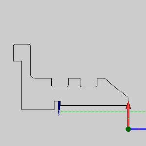

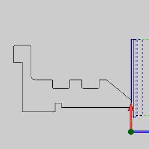

Part 3) Facing the Part
For most every Turning Job, you will need to face off the stock.By selecting a Lathe End Face feature, we will automatically create toolpath up to the machine zero without the need to select geometry.The only time geometry will need to be selected for the Lathe End Face feature is if the desired toolpath needs to end before, or, continue beyond the machine zero.
Add the Feature
  1. In the CAM Tree, right-click Machine Setup - 1 and selectLathe End Face.
    The Lathe End Face feature launches with the Geometry Selection pageactive.Since our target geometry is already at the machine zero, we do not need to select geometry.
  2. Click Next>>to continue to the Feature page.
Create Feature Extensions
  1. Select the Extensioncheck box and, in the End Distancebox, enter a value of 0.1000.
Select a Tool
    The Tool Crib launches.
    The Tool Library launches.
  3. Select tool number 263to highlight the CNMG - 3/64RAD - ROUGH TURNINGtool.
  4. Click OKto exit the Tool Library and return to the Tool Crib.
  5. Click OKto exit the Tool Crib and return to the Lathe Wizard.
  6. Select Parameters.
Adjust Parameters and Compute
Tip: In this case, we use our roughing tool to rough and finish the face.Since we use the same tool for the rough and finish, the need to create a separate finish operation is avoided by utilizing the Rough Allowance.The RoughAllowance ceases the roughing operation at the values entered and creates an additional semifinish pass up to the Finish Allowance specified next.
  1. In the Finish Allowancegroup, change both the Z and, X value to 0.0000.
Blank Toolpath

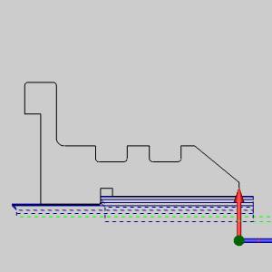

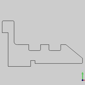

Part 4) Turning the Part

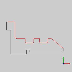

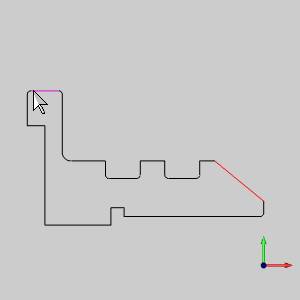

In this step we create a Lathe Turning feature, assign Rough and BasicFinish operations, and define the parameters of those operations.

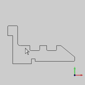

  1. In the CAM Tree, right-click Machine Setup - 1 and selectLathe Turning.

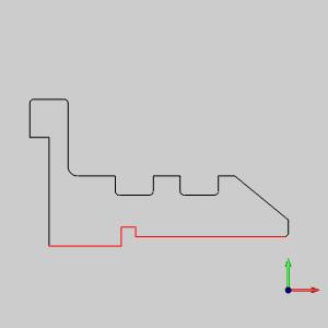

  2. Click SelectGeometry.
    The Lathe Wizard hides and the Feature Geometry Picking dialog opens to allow geometry selection.
  3. In the graphics area the entire model as our geometry:
    1. Left-click
    2. Going to
    3. Click OK to confirm the geometry selection and return to the Lathe Wizard.
Tip: To confirm geometry selections, you can also click the icon in the toolbars or simply press Spacebar.
Left-click
Shift + Left-click
Result
  1. In the Lathe Wizard, click Next>>to continue to the Feature page.
Adjust Feature Settings
  1. In order to avoid cutting the grooves with these operations, select the Remove Primary Undercut check box in the Undercutgroup.
  2. To continue beyond the selected geometry, select the check box for Extensionand enter a value of 0.2500into the End Distance box.
  3. Click Next>>to continue to the Machining Strategypage.

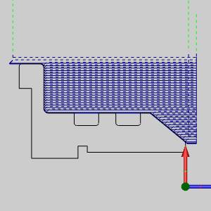

Set the Machining Strategy
  1. Select Rough / Finish in the Machining Strategy section of the Machining Strategy page to assign a Rough and BasicFinish operation to the feature.
  2. Select Parameters.
Adjust Parameters
  1. Adjust the Zvalue of the Finish Allowanceto 0.0010.
  4. Select Finish.
Tip: In this case, our stock has already been faced off.In order to avoid unnecessary feed movement, we use the Trim to Stock option to set trim the toolpath to the Operation Stock.
Select a ToolandCompute
  1. Click Tool Crib.
  3. Select tool number 277to highlight the VNMG - 1/32RAD - FINISH TURNINGtool.
  4. Click OKto return to the Tool Crib.
  5. Click OKto return to the Lathe Wizard.
  6. Click Compute.
Blank Toolpath

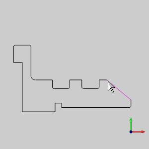

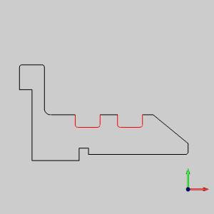

Part 5) Grooving the OD
In this case, we have two grooves that need to be completed on the OD of the part and one groove on the ID.Right now we will focus on the two OD grooves.
  1. Right-click Machine Setup - 1 in the CAM Tree and selectLathe Groove.
    The Lathe Wizard launches.

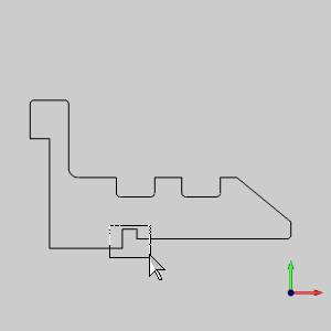

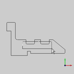

  2. Click Select Geometry.
  3. In the graphics area:
    1. Left-click
    2. Drag a window
Left-click + Hold
Drag Window and Release
Result

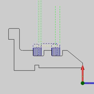

  5. Select tool number 281to highlight the 1/8 WIDE - 1/64RAD - OD GROOVE tool.
  6. Click OK.
  8. Select Patterns.
  2. Select the check box for Rough Allowance and adjust the Xvalue to 0.0050.
  3. Under Semifinish Pattern, set the Overlapvalue to 0.0050 to ensure that each of the downward semifinish cuts will go slightly beyond center.
  5. Click Compute.

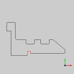

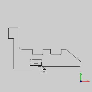

Part 6) Boring the ID
Now that we have completed the outer diameter of the part, we need to begin working on the inner diameter.The first thing we will work on is a basic Rough and Finish.
    1. Left-click
    2. Drag a window
    3. around the entire groove.The groove and connected entities highlighted.
    4. Press confirm the geometry selection.
Left-click + Hold
Result

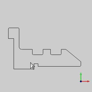

Part 7) Grooving the ID
    1. Left-click
    2. Drag a window
Left-click + Hold
Result

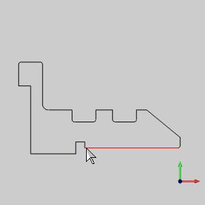

  3. Under Constraints,select Custom and then clickPick since the material has already been removed for a portion of this geometry, we can change where the toolpath begins.
  4. Highlight the
  5. top edge of the smaller wall of the groove, connecting entity to the right of the groove, and left-click.
  6. Confirm the geometry selection.

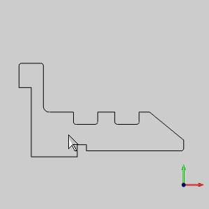

    1. Select the entity to the right of the
    2. Drag a window around the entire groove.The groove and connected entities highlighted.
    3. Press confirm the geometry selection.

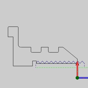

  3. Select Thread.
Select a Tool
  1. Click Tool Crib.
  3. Select tool number 505to highlight the 60 DEG - LAY DOWN - ID THREAD .IC  tool.
  4. click OK.
  5. In the Tool Crib:
    2. Click OK.
Set Parameters and Compute
  1. Under Parameters,set Threads Per Unit to 5.0000.
  2. Select the check box for Overrideand set Thread Height to 0.1190.
Important: The ThreadHeight that is calculated in BobCAD-CAM is the theoretical sharp height.Depending on the thread being cut, you may need to adjust this value.
  1. Click Compute.
Blank Toolpath

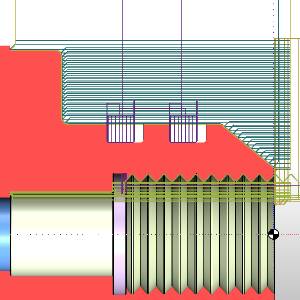

Part 9) Simulation
Open and Close Simulation
  1. In the Modulesmenu, click Simulation.
For help with simulation, view GettingStarted with Simulation.
Tip: The Simulation contains a CutSim tab.Clicking on the Advanced Properties button will launch the Parameters dialog allowing you to select the Enable check box in the Section plane group. This will put the stock in the section plane view seen in the image above.Leave the values as they are and click OK.
