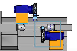

This tutorial walks you through creating a Mill Turn job to completely machine an example part on the BC 2T 2S mill-turn machine as shown in the Mill Turn Tutorials topic. This is a two turret, two spindle configuration with live-tooling and Y-axis machining capabilities on the upper turret. In addition to understanding the machine for which we are programming, it is also important to know the naming convention used for the submachines (work zones) as follows.
BC 2T 2S Mill Turn Machine

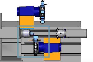

BC 2T 2S Submachine Naming
LT_MS = Lower Turret, Main Spindle
LT_SS = Lower Turret, Sub Spindle
Example Part
The following images show our example part. For this tutorial, we machine the part using stock that is already cut to length. For this reason, we create our features as though the model is split into two halves: front and back. This allows us to machine the front half of the part on the main spindle before transferring the part to the sub spindle and machinable back half. This is important to understand as this determines how we create some of our features.

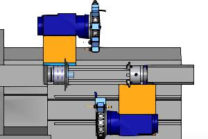

Machine Setups
For this tutorial, all features are created using one of two machine setups: one for the front side and one for the back side of the part. The following images show the location and orientation of the machining origin (work offset) for each setup.
Machine Setup1
Machine Setup2

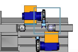

The first three features that we create use the LT_MS (lower turret, main spindle) submachine or work zone. Instead of changing the submachine in the Posting page of each feature, we change the submachine in the CAM Tree to determine the default submachine for creating new features.
  1. Under Machine Setup - 1, right-click the current submachine name (UT_MS), and click Edit.
  2. Under Submachine Name, click the down arrow, and select LT_MS.
  3. Click OK to update the default submachine.
    All machining features created under MachineSetup - 1 are automatically set to use this submachine. The submachine can always be changed in the Posting page of the wizard.

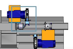

Machine Setup 1
It is important to think about the machine setup (machining origin) when creating machining features for Mill Turn jobs. All of the features that we create to machine the front half of the part are created under Machine Setup 1. The machining origin for this machine setup is at the front face of the part, not the stock, (we are facing to zero).

  1. Right-click Mill Turn Job,and click Simulation.
For more help using simulation, view GettingStarted with Simulation.
