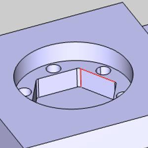

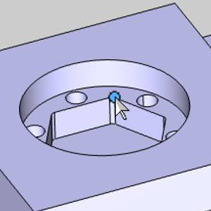

Part 3) Set the Start for the Toolpath Pattern
With the Toolpath Pattern dialog launched, we are now able to set the Specified Points. If the distances between the original and its copies are known, the Start can be left at zero and the differences can be entered. In this case we will use the Pick options to set the Start and use the pointhighlighted in the image below.
Important: Pick options reference values in relation to the Machine Setup
  1. Click the Pickbutton in the Start group to set the start position.
    The Toolpath Pattern Dialog hides and selection mode is enabled.
  2. Click the seen in the image and click OK.
    The Toolpath Pattern dialog returns.

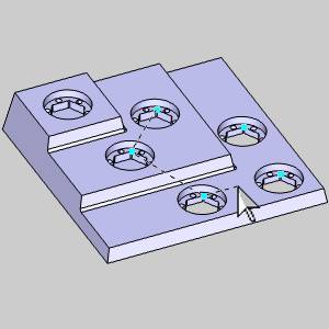

Part 4) Set the Positions
The Start and Positions determine the distances of our toolpath duplicates from the originals. Since we have used the Pick option to select our Start, we will use the Pick Positions option to select our Positions.
  1. Click Pick Positions.
  2. Take care to select the matching point for each of the remaining pockets in the order they are to be machined.
Part 5) Set the Machining Order
The last group in the lower right of the Toolpath Pattern dialog box, is Machining Order. This group will allow you to select from Optimized, or Pick Order. To have control over the order our copies are machined in, we will need to set the Machining Order to Pick Order.
  1. Click the Pick Order option in the Machining Order group.
  2. Click OK.
    The Toolpath Pattern dialog closes.
    The toolpath will now be machined in the order the Positions were selected.

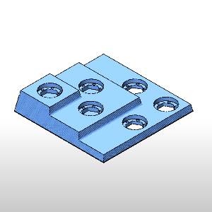

Part 6) Simulate the Program
  1. To view the part being cut, right-click Milling Job,and click Simulation.
To learn more about using Simulation, viewGetting Started with Simulation.

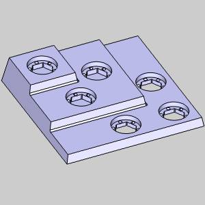

The resulting stock model is shown next.
  1. To close the simulation, click Exit Simulation.
