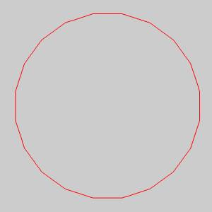

The parameters open in the Data Entry manager, and the Preview displays.
- Enter 20 for the Number of Sides value.
The Preview updates.
- Click OK to confirm the settings and placement of the Polygon Inner.
The Polygon Inner is created in the graphics area, and the Polygon Inner feature is added to the CAD Tree. - In the Entity group, of the Create 2D ribbon, click the down arrow under

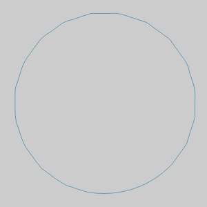

Fit Arcs. - Notice the Tolerance value is set 0.0004.
Click anywhere in the graphics area to give it focus, and press Ctrl+A on your keyboard to use the shortcut for Select All.
The entities are selected. - Click OK to confirm.
A dialog appears with the message: Arcfit result will return more entities than started with, you may want to increase the tolerance, would you like to continue? - Click Yes.
The Results dialog appears showing: Arcs Created 14 - Click OK.
The result displays in the graphics area.In this case, the results are not obvious. - Click anywhere in the graphics area to give it focus, and press Ctrl+Z on your keyboard to Undo the Arc Fit.

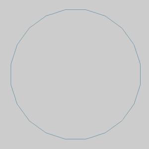

- Change the Tolerance value to 0.0040.
The Results dialog appears showing: ArcsCreated 1 - Click OK.
Again, the result displays in the graphics area. The results are still not obvious. - Click anywhere in the graphics area to give it focus, and press Ctrl+Z on your keyboard to Undo the Arc Fit.

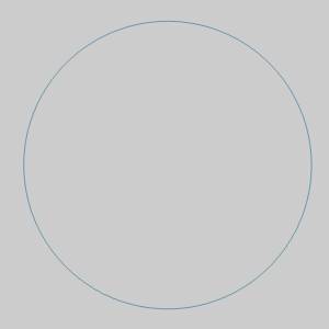

- Change the Tolerance value to 0.040.
- Click anywhere in the graphics area to give it focus, and press Ctrl+A on your keyboard to use the shortcut for Select All.
The result displays in the graphics area, and this time we can see a single arc has been created. - To end the function, click Cancel.
