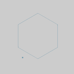

The Point Perpendicular function is used to create points on existing geometry, at a location that is perpendicular from another selected point geometry. This is accomplished by selecting a point, and wireframe geometry, or visa versa.
Note: As seen below, this function will also produce points on what would be the extension of the selected wireframe entity.

Part 2) Create Points Using Point Perpendicular
- In the Entity group of the Create 2D ribbon, click the down arrow under
Point, and select
Point Perpendicular. - Move the pointer to the reference point that is inside the geometry (so that it displays in the Highlight color), and click to select it.
The reference point changes to the selection color.
Note: When using Point Perpendicular, you can select the reference point or the wireframe entity first. The result of the function is the same for either method. In this example, we select the reference point first so that we can use the CAD preview to see where the (perpendicular) point will be created on any of the wireframe entities before performing the function.
Point to the spline, and notice the CAD preview.
Point to the lower line and click to create the point.(In the following images, the active drawing color was changed to make it easier to see the points created with Point Perpendicular.)
That is all that is needed to perform the function. You can repeat this process to create many points as needed.
