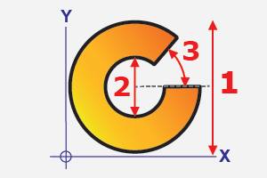

Cut Ring (Shape 3)
1 - the outside diameter.
2 - the inside diameter.
3 - the angle range of the slot measured counterclockwise starting at 0.00 degrees.
Tip: If using a large value for P3, it may be better to use Ring Segment. The Ring Segment uses the arc center as the origin and it is calculated with a smaller bounding box than Cut Ring.

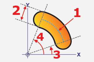

Curved Slot (Shape 6)
1 - the radius or distance from the shape origin to the center of the slot.
2 - the width of the slot centered on the radius (P1).
3 - the start angle measured from zero degrees or the X-axis of the shape origin.
4 - the end angle measured from zero degrees or the X-axis of the shape origin.
Note: For P3 and P4, the angle is a positive or negative value between 0.00 and 360.00 degrees. The angle is measured to the arc center at the ends of the slot as shown in the diagram.

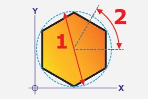

Outer Polygon (Shape 9)
1 - the outside diameter of the polygon. All sides are created within this diameter (the intersection of any two sides meet this diameter).
2 - is the amount of rotation in degrees around the shape center. The rotation angle is applied counterclockwise from zero degrees (3 o'clock).
Number of Sides - the number of sides for the polygon, which must be greater than two.
Tip: One side of the polygon is always created parallel to the Y-axis.

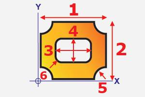

Frame with Rectangular Hole (Shape 16)
1 - the total length or X-axis dimension from the shape origin.
2 - the total width or Y-axis dimension from the shape origin.
3 - the length or X-axis dimension of the rectangular hole. This is automatically centered on the shape (P1).
4 - the width or Y-axis dimension of the rectangular hole. This is automatically centered on the shape (P2).
5 - the corner radius of the inverse fillets.
6 - the corner radius of the rectangular hole.

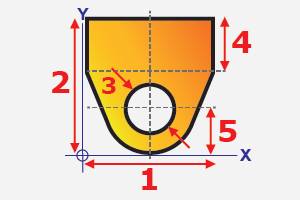

Symmetric Lug (Shape 18)
3 - the diameter of the inner hole.
4 - the shoulder width or Y-axis dimension from the top of the shape to the bottom of the vertical walls.
5 - the center of the hole or Y-axis dimension from the shape origin.

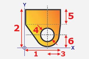

Asymmetric Lug (Shape 19)
3 - the hole center or X-axis dimension as a positive value from the right boundary (the end of P1). If you set this value to 0.00, the center of the hole is moved to the end of P1, thus changing the shape of the lug.
4 - the diameter of the inner hole.
5 - the shoulder width or Y-axis dimension as a positive value from the top of the shape to the bottom of the vertical walls.
6 - the hole center or Y-axis dimension from the shape origin. (This is also the outer radius of the lug.)

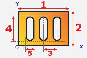

Slotted Plate (Shape 28)
3 - the distance between slots or X-axis dimension.
4 - the slot width or Y-axis dimension.
5 - the slot length or X-axis dimension.
Number of Slots - the number of slots in the plate.

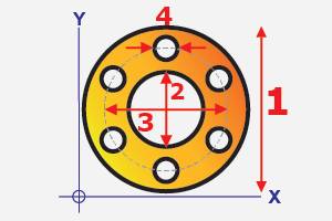

Round Flange (Shape 29)
1 - the outer diameter.
2 - the inner diameter. This can be set to zero to remove the center hole.
3 - the diameter of the hole/bolt pattern.
4 - the diameter of each bolt hole.
Number of Bolts - the number of bolt holes in the flange.

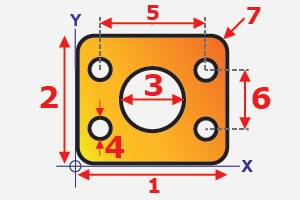

Rectangular 5 Hole Flange (Shape 30)
3 - the diameter of the center hole or X-axis dimension, which is automatically centered on the shape (P1). This can be set to zero to remove the center hole.
4 - the diameter of the four outer holes. This can be set to zero to remove the holes.
5 - the horizontal distance between the left and right bolt holes or X-axis dimension, which is automatically centered on the shape (P1).
6 - the vertical distance between the upper and lower holes or Y-axis dimension, which is automatically centered on the shape (P2).
7 - the corner radius of the flange.

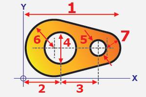

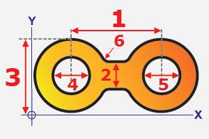

Cam Plate (Shape 31)
2 - the left hole center or X-axis dimension from the shape origin.
3 - the distance between holes as an X-axis dimension.
4 - the diameter of the left hole, which is automatically centered on the shape vertically.
5 - the diameter of the right hole, which is automatically centered on the shape vertically.
6 - the outer radius of the left side of the plate.
7 - the outer radius of the right side of the plate.

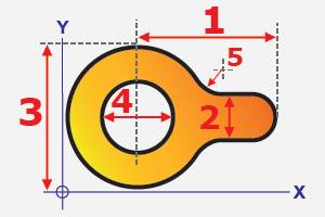

Lollipop (Shape 32)
1 - the distance from the center hole (or half of P3) to the right boundary of the shape as an X-axis dimension.
2 - the thickness or Y-axis dimension for the right side of the shape (tab).
3 - the total width or Y-axis dimension from the origin. This is the diameter of the left side of the shape.
4 - the center hole diameter, which is automatically centered in the diameter (or P3).
5 - the corner radius between the tab and the diameter (the transition radius).
Chain Link (Shape 33)
1 - the distance between holes as an X-axis dimension.
2 - the thickness of the tab (or transition) between the left and right halves.
3 - the total width or Y-axis dimension from the shape origin. This determines the outer diameter of the left and right sides.
4 - the diameter of the left inner hole. The value may be set to zero to remove the hole.
5 - the diameter of the right inner hole. The value may be set to zero to remove the hole.
6 - the corner radius of the tab between the left and right diameters (the transition radius).

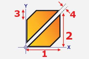

Wedges (Shape 34)
1 - the wedge length or X-axis dimension from the shape origin.
2 - the wedge width or Y-axis dimension from the shape origin.
3 - is the bevel width or Y-axis dimension applied to both wedges as a positive value. Setting this value to 0.00 creates both wedges with 90.00 degree sharp corners.
4 - the distance between the two wedges or the gap dimension. (Changing this dimension doesn't change the size of the wedges, but rather moves the upper wedge up in Y, so that it has the same dimensions as the lower wedge.)

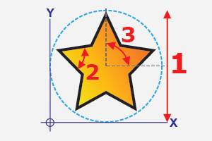

Star (Shape 37)
1 - the diameter used to create the star. The outer points of the star meet this diameter.
2 - the angle range of the star corners.
3 - is the amount of rotation in degrees around the shape center. The rotation angle is applied counterclockwise from zero degrees (3 o'clock). With a value of zero, one of the corners points to zero degrees. A value of 90.00 degrees moves this corner to the 12 o'clock position.
Number of Corners - the number of corners for the star.
