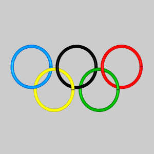

Example - Extract Isocurve
- In the Quick Access Toolbar, click
New. - In the Primitives group, of the Create 3D tab, click
Torus.
The preview appears.
- Leave the default values as they are and click OK.
The torus is created.
- In the Origin group, update the X value to 1.000.
The preview updates.
- Click OK.
In the Utilitiesgroup, of the Create 2D ribbon, click
Silhouette. -
In the Layers Manager, click
to add a layer.
The new layer is automatically set as the active layer. -
Select both solids.
In the Options group, deselect Internal Shapes and click OK.
The silhouette is created. -
Hide the CAD layer to view the silhouette.
Notice there are two separate outlines for each solid. -
Press Ctrl+Z to undo and show the CAD layer again.
Select the check box for Internal Shapes and create another silhouette.
Notice we now have the internal and external outlines for each. -
Clear the check box for Internal Shapes, select Merge All and repeat this process.
Notice we now have an overall outline of both solids handled as a single item. -
Select the check box for Internal Shapes and repeat this process.
In this case we still handle all solids as a single item but we now show the internal outline as well.
That concludes this example.
