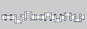

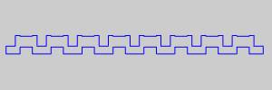

Tip: When the selected geometry to pull the spun profile from is parallel to an X, Y, or Z axis, using Pick Axis is not necessary. When it is askew of an axis, Pick Axis makes it simple.See the images below for a situational example of each.

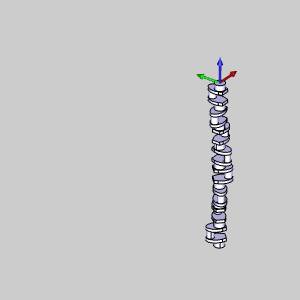

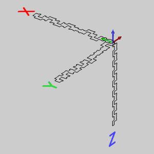

Important: In the images below, you will see a solid and the three different Spun Profile results that were pulled from it. Entering a value in the Y Direction produces the profile labeled Y. Entering a value in the X Direction produces the profile labeled X. Entering a value in the Z Direction produces the profile labeled Z.
Solid |
3 results |
