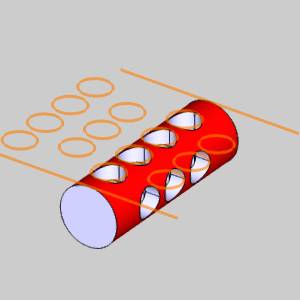

The Unwrap function unwraps cylindrical geometry to create groups of 2D geometric entities.

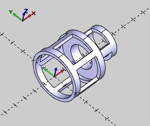

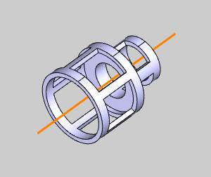

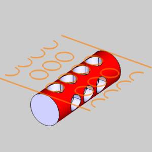

Part 1) Part Orientation and the Unwrap Rotation Center Axis Overview
The Unwrap function can accommodate various part orientations. When the rotational center of the part is aligned directly along the X-, Y-, or Z-axis, set the Unwrap Rotation Center Axis to the appropriate axis.
For the following example, X Axis is selected.
Example Part with X-Axis Orientation |
You can also draw a line through the rotational center of the cylinder to manually select as the Unwrap Rotation Center Axis. You select the line after selecting the unwrap geometry.
Using a Line for the Unwrap Center Axis |
Another way to deal with custom part orientations is to use the User Defined option.
When selected, the Origin and Direction groups become available.
In the Origin group, type X-, Y-, and Z- values to define a point along the Unwrap Rotation Center Axis.
In the Direction group, type the X-, Y-, and Z- values to define the direction from the Origin.
For example, the following image shows the part with the center axis aligned to +X5 (parallel to the Y-axis).
Notice that the Direction values define the direction as parallel to the Y-axis.
User Defined for the Unwrap Center Axis |
User Defined Values |

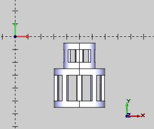

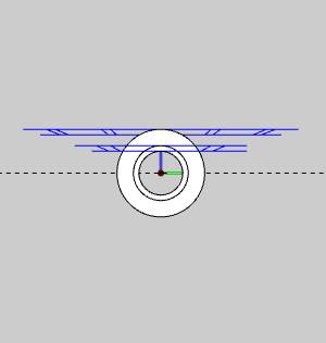

Part 2) Using the Automatic option for the Unwrap Diameter
For this example, the part is oriented along the X-axis as shown in Part 1.
In the Unwrap Rotation Center Axis group, select X Axis.
In the graphics area, drag a window to select the entire part.
Press the Spacebar to confirm the selection.
Geometry Selection |

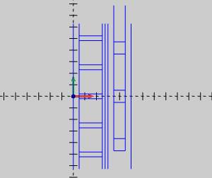

The geometry is unwrapped using the actual diameter of each section of the part.
In the next image, the part is hidden to better show the unwrapped geometry.
Unwrapped Geometry Top View |
Right View with Part Shown |
To exit the Unwrap function, in the Data Entry tab, click Cancel.

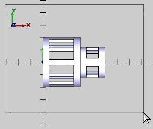

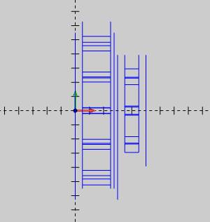

Part 3) Using the User Defined option for the Unwrap Diameter
This example uses the same part and orientation as in Part 2. For this example, the geometry is unwrapped using the greatest diameter of the part which is 4 units.
In the Utilities group, of the Create 2D ribbon, click
Unwrap. - In theUnwrap Diameter group, select User Defined.
In the User Defined box, type 4.00.
To confirm the selection, press Spacebar.

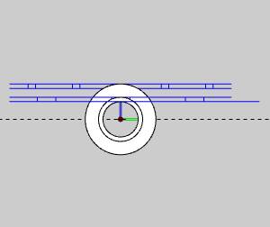

The geometry is unwrapped using the User Defined value of 4.00 units.
