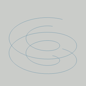

In the example file, the geometry for the ruled surface is two 3D spirals (helices) that consist of many line segments. Ruled Surface uses two wireframe chains to create a surface with a linear connection between the chains. For the first part of this example we see the result of the spline curves made of line segments.

Using the Auto-Chaining option with Constant Z off, click the small line segment at the upper end of the helix.
The start and end arrows display to show the first chain is selected. -
Select the second helix using the same method. Be sure to click near the upper end of the helix to define the same chain direction as the first chain.
When you complete the second chain selection, the surface preview is automatically created.
Notice the preview of the resulting surface is many small surfaces, one for each set of line segments in the two helices.
In order to create the surface as a single smooth surface, we use an Approximated Spline to create a single entity from each helix.
