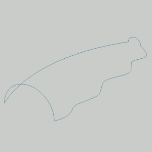

The first step is to select a chain to assign as a Cross Section Curve.
Turn off Auto-Chaining, select the Multi-Entity mode, and highlight the entity as seen in the image below.
Since this is a single entity, one click gives us the intended start and end of the chain automatically.
Tip: While selecting the geometry for a cross section, you can click the start arrow to change the direction of that cross section, or use the Reverse button after highlighting that chain in the Selected Geometry list of the Cross Section Surface parameters in the Data Entry Manager. It is important that all of the cross sections share the same direction.
Hover over the end of the next Cross Section, as seen in the image below.
Click the entity.
In the Picking Manager, click End Chain.
The chains are added to the Cross Section Curves list.
- In the Data Entry Manager, click in the Rail Curves list to give it focus.
In the Picking Manager, switch to Manual Chaining and hover over the end of the first Rail, as seen in the image below.
Click the entity to set the start and end of the chain.
Click End Chain.
The chain is added to the Rail Curves list. -
The second rail is the first of our chains that is comprised of several entities. Hover over the end of the first entity of the second Rail, as seen in the image below.
Click the entity to set the start of the chain.
Highlight the end of the last entity of the chain, as seen in the image below.
Click to set the end of the chain.
Now, with enough Cross Sections Curves and Rail Curves to create a surface, the Preview appears. -
