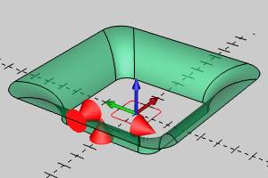

After selecting the profile curve, the CAD preview displays in the Workspace.
Notice the resulting surface. The profile curve follows the trajectory curve while being revolved around the Z-axis of the Active UCS. (Also, the direction of the profile curve does affect the result when using Follow Trajectory Curve as it defines where the profile starts and ends in relation to the path.)

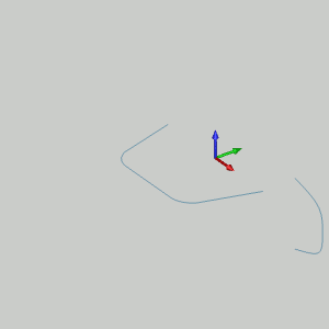

Example Geometry and UCS

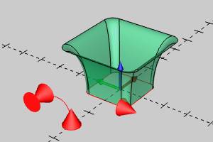

New UCS
Result
