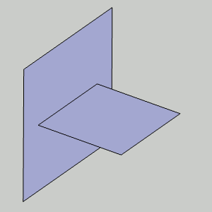

The boundary options determine how the fillet is trimmed at the outer boundaries. The following image shows the two original surfaces as a reference to the result shown below each option.
No Trim - creates the fillet between the two surfaces, but does not trim the outer edges of the fillet. The resulting fillet exceeds the larger surface by the radius amount.
First Surface/Solid
Second Surface/Solid

Hover over the surface created on the Front Plane as shown in the image below.
Select the surface.
The surface is added to the First Surface/Solid list.
Hover over the surface created on the Top Plane as shown in the image below.
Select the surface.
The surface is added to the Second Surface/Solid list and the Preview appears showing the result if the default Blend option is used.
