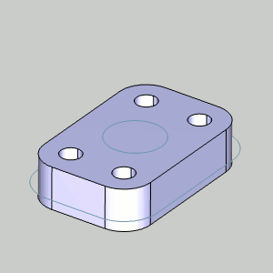

Part 3) Create the First Extrude Boss
For the first Extrude Boss, we use data entry only.
Tip: For the creation of the initial solid, you could also use Extrude Curve and get the same result. The Extrude Boss will combine any intersecting solid or surface, even if that intersecting solid or surface is on a hidden layer.
In the Data Entry Manager under Positive Direction, double-click in the Distance box to select all the text.
Type 0.625 to update the Distance value. -
In the graphics area, click and drag a window to select the wireframe flange shape.
The entities go into the Selected Geometry list and the Preview appears.
In the Selected Geometry list, highlight Arc-10.
The arc highlights in the graphics area.
With Arc-10 highlighted in the Selected Geometry list, click
(Delete).
The arc is removed from the Extrude Boss Preview.
Note: The center circle is removed because it is used later to create another boss. The other four circles are selected because we want them to create the holes for the flange. By including these in the first extrude, we eliminate the need to cut the holes using another CAD function.
Leave the Scope set to All Bodies, and click OK to confirm.
The Extrude Boss is created in the graphics area and an
Extrude Boss feature is created in the
CAD Tree.
That is all that is needed to create an Extrude Boss feature.
Leave the Extrude Boss function open.Another boss is created in the next part of this example.
