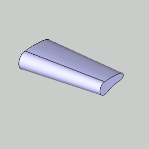

Intended result:

Part 7) View the Result
To see what we have created, we will hide the rest of the geometry.
Press Ctrl+7 to get into an ISO 2 view.
The View updates.
In the Layers Manager right-click the Solidlayer.
Select Hide.
The extruded Cam Plate hides and we can see the result of our Imprint.
