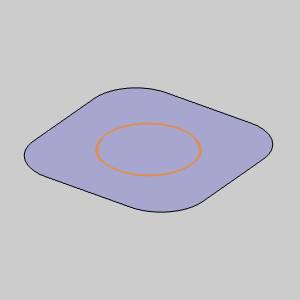

The Preview appears.
Change the Radius value to 0.5000.
The Preview updates.
Click OK to confirm the arc.
The arc is created.

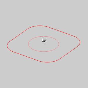

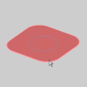

The Surface/Solid to Break list is automatically given focus to allow selection of the surface or solid to break. -
Hover over the Rectangular Plane as seen in the image below.
Click the Rectangular Plane to add it to the Surface/Solid to Break list.
The Rectangular Plane is added to the Surface/Solid to Break list.

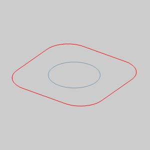

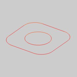

Press S to turn toggle the
Shaded view.

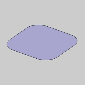

The shading is removed from the Rectangular Plane.
Tip: With the Shaded view turned off, the surfaces or solids can only be selected by clicking on one of its edges. This allows us to select geometry that may be on, inside, or behind the surfaces or solids.
Hover over the arc as seen in the image below.
Click the arc to add it to the Breaking Curves list.

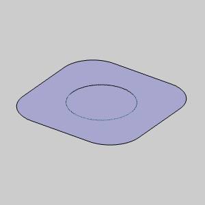

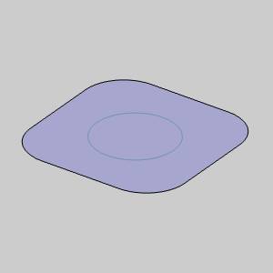

Shadedview.
The shading is added to the Rectangular Plane.

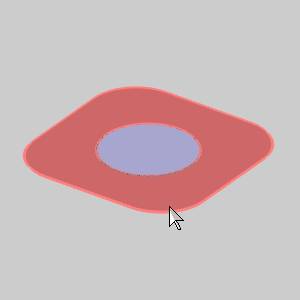

Click OK to confirm the break.

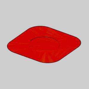

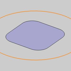

The surface is broken, and a
Break Surface feature is added to the
CAD Tree.

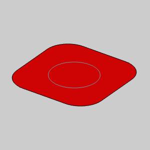

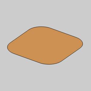

Hover of the Rectangular Plane as seen in the image below.
Notice there are now two separate surfaces. -
