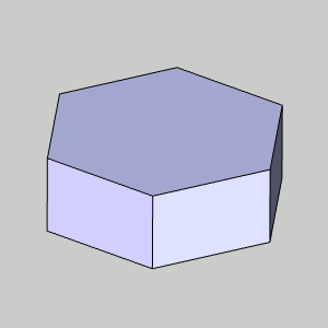

The Solid Shell function is used to remove one or more faces of a solid body and recreate the solid with the specified wall thickness for the remaining surfaces. You can also shell the whole solid to create a closed hollow solid.
