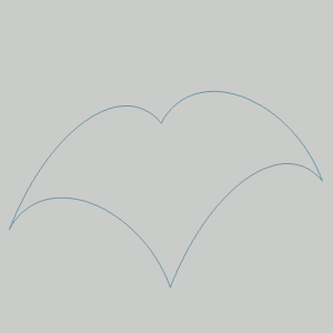

Highlight the end of the first entity, of the first chain, as seen in the image below.
Note: In this example, each chain is a single entity. If these chains were multiple entities; With Manual Chaining, click the end of the first entity of the first chain to set the start point and direction of the chain. Then click the end of the last entity of the first chain to set the end of the chain. Then repeat for the subsequent chains.
Click the entity to set the start and end of the chain.
In the Picking Manager select End Chain.
Tip: While selecting the geometry for a 4 Edge, you can click the start arrow to change the direction of that cross section, or use the Reverse button after highlighting that chain in the Selected Geometry list of the 4 Edge Surface parameters in the Data Entry Manager.It is important that all of the chains share the same direction.
Hover over the end of the next chain, as seen in the image below.
Click the entity to set the start and end of the second chain.
The chain is added to the Selected Geometry list. -
Hover over the end of the third chain, as seen in the image below.
Click the entity to set the start of the third chain.
Hover over the end of the last chain, as seen in the image below.
Click the entity to set the start and end of the last chain.
The chain is added to the Selected Geometry list and the preview appears. -
