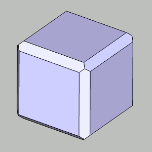

This example will demonstrate how to use the Copy Face function on a primitive solid with added chamfers.
Part 1) Create the cube
Open a new file.
Press Ctrl+7 to enter an ISO2 view.
In the Primitives group, of the Create 3D tab, click
Cube.
The preview appears. -
Click OK to create a cube with the default values.
The cube is created. -
Click Cancel to exit the dialog.
The dialog closes.
Part 2) Add the chamfers
In the Corners group, of the Create 3D tab, click
Solid Chamfer.
The Solid Chamfer dialog opens in the Data Entry Manager. -
In the Parameters section, select the check box for Whole Solid.
Select the cube.
The cube is added to the Selected Geometry list. -
Click the Show Preview button.
The preview shows the result using the default Chamfer Width value. -
Click OK to create the chamfers.
