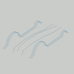

This example will demonstrate how to use the Cross Section function.
In the quick access toolbar, click
Open. -
Select cross section surface example.bbcd, and click Open.
The file opens.
Leave the file in the ISO 2 view. -

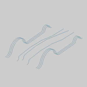

In the Surfaces group, of the Create 3D tab, click
Cross-Section.
The Cross Section Surface parameters display in the Data Entry Manager and the Picking Manager appears. -

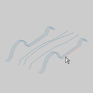

In the Picking Manager, turn off Auto-Chaining and select Manual Chaining.

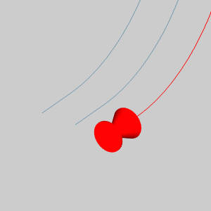

Highlight the entity as seen in the image below.

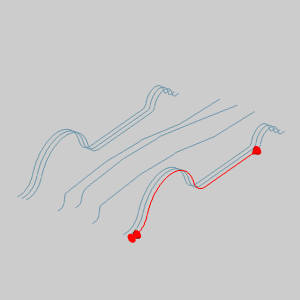

Click the entity to set the start of the chain.
Highlight the end of the chain as seen in the image below, and click to continue the chain to this entity.
The chain continues to the end.
In the Picking Manager, click End Chain.
Tip: To chain select a portion of a chain, as we have done here, click near the end of the first chain entity to set the start of the chain, then hold click near the end of the last entity to set the end of the chain.To select an entire chain at once with Auto-Chaining off, hold Shift and click near the end of the last entity to set the start and end of the chain in one click.
Note: While selecting the geometry for a cross-section, you can click the start arrow next to the Selected Geometry list to change the direction of that cross section, or use the Reverse button after highlighting that chain in the Selected Geometry list of the Cross Section Surface parameters in the Data Entry Manager. It is important that all of the cross sections share the same direction.

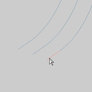

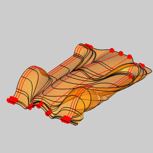

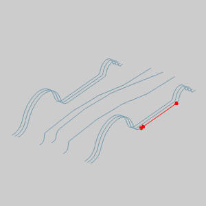

In the Picking Manager, turn on Auto-Chaining, turn off Constant Z, and hover over the end of the next chain, as seen in the image below.
Click the end of the entity to chain select the entire chain.

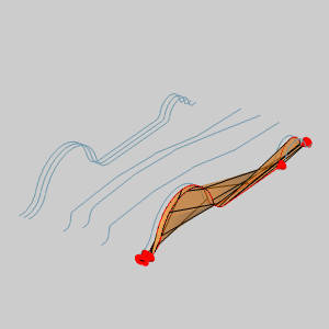

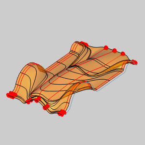

With two cross sections added to the Selected Geometry list, the Preview displays. -
Repeat step 11 for each of the subsequent chains, in order, until all are added to the Selected Geometry list.

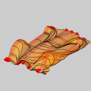

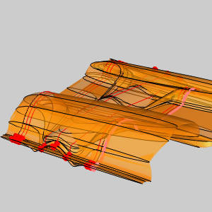

Notice the difference between the two sides. Even though the last four chains are mirror images of the first four chains, selecting only a portion of the first chain, as we have done, has created some irregularities.
We will correct that in the next steps. -

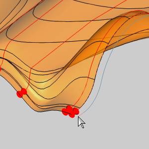

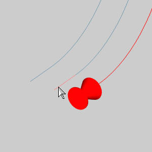

Hover over the end of the deselected chain as seen in the image below.
The chain is added to the Selected Geometry list as Chain-10 and the Preview updates.

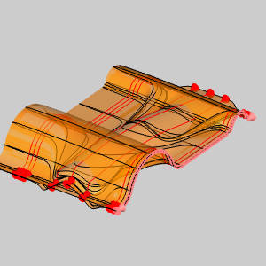

Because the order of the chains in the Selected Geometry list is wrong, the Preview shows an unintended result. We will correct that in the next steps. -

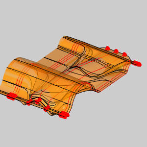

In the Selected Geometry list, click Chain-10 to highlight it.
The chain highlights in the graphics area. -
Click the
(Move Up) button to move Chain-10 up the list.
The Preview updates.
The order is still off. We need to move Chain-10 to the top of the list. -
Click the
(Move Up) button to move Chain-10 up the list, until it is at the top of the list.

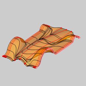

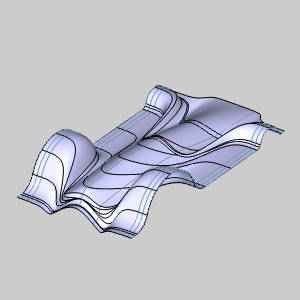

Click OK to finalize the Cross Section.
The surface is created and a
Cross Section feature is created in the
CAD Tree.
