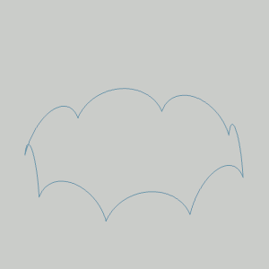

In the Picking Manager, turn off Auto-Chaining, and highlight the end of the first entity, of the first chain, as seen in the image below.
Note: In this example, each chain is a single entity. If these chains were multiple entities; With Manual Chaining, click the end of the first entity of the first chain to set the start point and direction of the chain. Then click the end of the last entity of the first chain to set the end of the chain. Then repeat for the subsequent chains.
Click the entity to set the start and end of the chain.
In the Picking Manager, click End Chain.
Highlight the end of the next chain as seen in the image below.
Tip: While selecting the geometry for a Multisided Patch, you can click the start arrow to change the direction of that cross section, or use the Reverse button after highlighting that chain in the Selected Geometry list of the Multisided Patch Surface parameters in the Data Entry Manager.Itis important that all of the chains share the same direction.
Continue with these steps, selecting each entity as an individual chain, until all chains are added to the Selected Geometry list.
With all chains selected the Preview appears.
Click OK to finalize the Multisided Patch.
