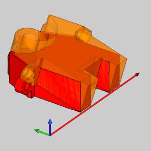

Example 1 (Enter the Revolve Axis)
Note: In the images below, the Show Axis X-Y toggle has been disabled in the Axis X-Y group of the Settings Part Display dialog.The Gnomon has been used to show the axes of rotation.
Open. -
Note: This is the default install location.If you performed a custom install, navigate to the location in which you installed the software.
Select revolved surface example.bbcd,and click Open.
The file opens.
Leave the file in the ISO 2 view. -
In the Surfaces group, of the Create 3D ribbon, click
Revolve Surface.
The Revolve Surface parameters display in the Data Entry Manager. -
Deselect the Preview check box.
Note: This step is not necessary to the creation of a Revolve and is used in this example only to allow us to see the result of the chain selection easier.
In the graphics area, hover over the entity shown below, and press and hold Shift, before clicking the entity to chain-select the entire chain.
Tip: Notice that the direction arrow is now displayed on the geometry. When you chain select an entity for functions that have a direction, the nearest snap point of the entity that you select is defined as the end of the chain. Alternatively, you can click an entity to define the start of the chain, and then hold Shift and click the end of another entity to define the end of the chain. The steps in this example eliminate the extra selection. When you are selecting a closed chain to revolve, the start and end location of the chain are not important.
Select the Preview checkbox.
The Preview displays.
In the Rotation Angle box, enter a value of 90.00 and press Tab.
The Preview Updates.
Select the With Caps checkbox.
The Preview updates to show the Revolve Surface being created as solid instead of a single revolved surface.
To create the geometry as shown in the CAD preview, in the Data Entry Manager, click OK. The profile is revolved 90 degrees around the X-axis and a
Revolve feature is created in the
CAD Tree.
This concludes Example 1. Leave the file open and continue to Example 2 to learn more about Revolve Surface.
