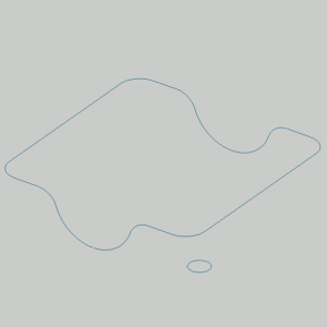

The first step is to select a point or snap point to assign as the Attachment Point of the Sweep Profile to the Sweep Path.
Hover over the small arc to display the snap points of the arc.
Click the snap point in the center of the arc to select it.
The point is added to the Attachment Point list and the focus is moved to the Sweep Profile list.
The next step is to select the Sweep Profile itself.
Press and hold Shift, and click the arc to select it define he profile geometry that is swept along the Sweep Path.
The chain is added to the Sweep Profile list and the focus is moved to the Sweep Path list.
Note: Because our Sweep Profile is a single entity, we used chain selection to define the start and end of the profile in one click. If you were using a group of connected entities as the sweep profile, you can still use this method, or you can click the start entity first, and then hold shift and click the last entity to define the end of the sweep profile. This method is helpful when you have a group of connected entities, but you don’t want to select them all. An example of this selection method is performed in the next step.
The next step is to select geometry as the Sweep Path.Becausewe are selecting a closed sweep path, we could just hold Shift and click anywhere along the path to select it and define the direction in one click.Instead, we use the two click method and skip an entity to show how it is done.
Click the end of entity shown below to set the start of the sweep path.
The start arrow of the sweep path displays.
To set the end of the sweep path, hold Shift and click near the end of the entity shown below.
The Preview displays.
Note: Even though the chain for the sweep path is a closed path, we have selected the chain in such a way that we have avoided including a particular entity. Had we held Shift when clicking the first entity of the sweep path, all entities would have been included.
