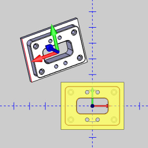

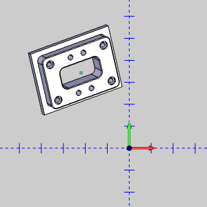

In this example, we have a part that has odd orientation and placement on import. The goal is to place the part center at the center of the world coordinate system, and correct its orientation at the same time.
- In the Move group, of the Utilities ribbon, click
Align.

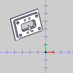

The function opens in the Data Entry Manager. - By default the Geometry option is set to All visible, and the From group is set to Coordinate System with focus on the Origin list box. This allows you to set up a coordinate system on, and aligned with the part, that we can use to move and orient the part as we would like.

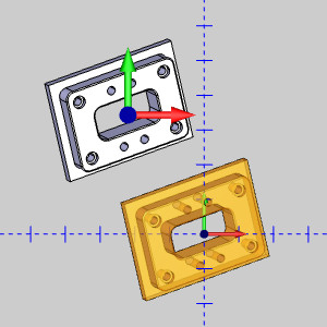

In the graphics area, click the point at the center of the part.
A coordinate system appears at the selected Origin, and we can see a preview of how our part will be placed with the settings as they are now.

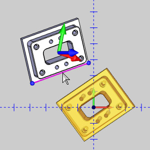

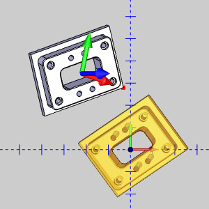

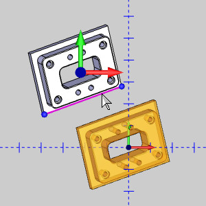

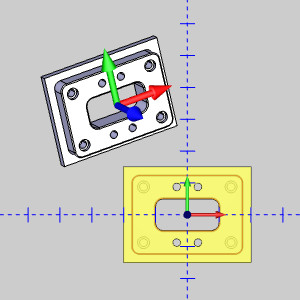

The X Direction list box is automatically given focus. - Hover over the bottom edge of the part and notice the snap points that appear.

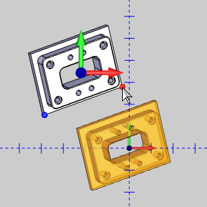

Click the snap point to the right.
The point is added to the X Direction list box, and focus is moved to the Y Direction list box.
Notice how our X Axis is pointing directly at the snap point. When a point is selected the axis points at it. When an edge or line is selected, the axis will be parallel to it.
Lets update our X Direction. - Click in the X Direction list box to give it focus again.
- Hover the bottom edge of the part and click it to update the X Direction.

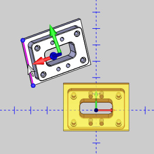

The X Direction is updated and focus is placed back on the Y Direction. - Hover over the left edge of the part to highlight it, then click the edge.
The Y Direction is updated, and the Z Direction list box is given focus.

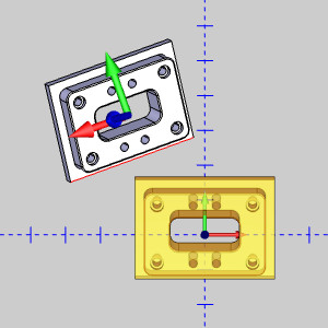

In the case of the Z Direction, we only need it to flip direction. Because of this, we do not need to select geometry to associate it with. - Next to the Z Direction list box, click
Reverse Direction.

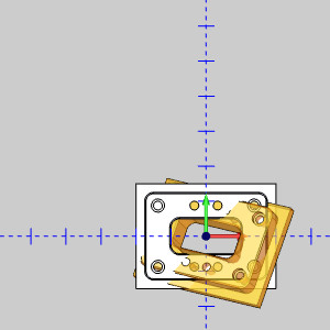

The Z Direction flips. - By default the To group is set to use an Existing UCS, with the Top (X/Y) UCS selected.In this case, this is what we want.

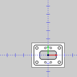

Click OK.
The part is moved and the preview updates to show how the part location and orientation will be updated if you were to click OK again. - Click Cancel to exit the function.
