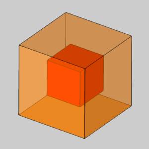

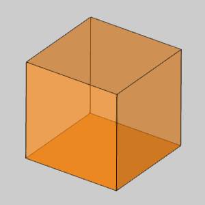

| Example Geometry | |
Scale Factors
The scale factor determines the ratio of scaling applied to the geometry. A value of 1.00 is equal to no scaling, 0.50 is equal to one half of the original size, and 2.00 is equal to twice the original size.
Scale Factor - sets the scale to use on the selected geometry. |
X - sets the scale in the X axis to use on the selected geometry. Y - sets the scale in the Y axis to use on the selected geometry. Z - sets the scale in the Z axis to use on the selected geometry. |
