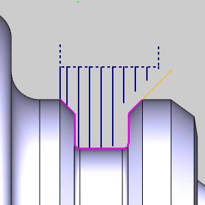

Material Approach

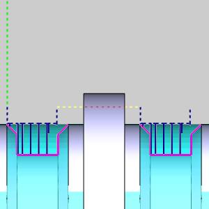

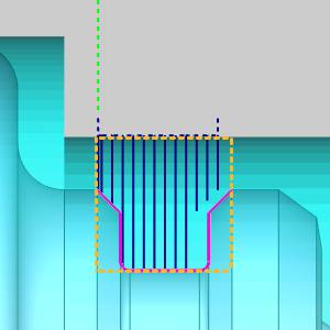

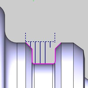

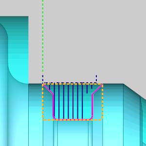

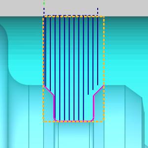

Rapid Plane - is the height at which the tool can rapid safely within a single operation. This value visualized as a dotted line in the toolpath and is an incremental distance above the Top of Feature defined in the Constraints section.
Rapid Crashing
Rapid Lifted
Warning: Rapids that are going through portions of the part are not highlighted in the software but merely go straight through. This rapid has been highlighted for visual aid in this help system.

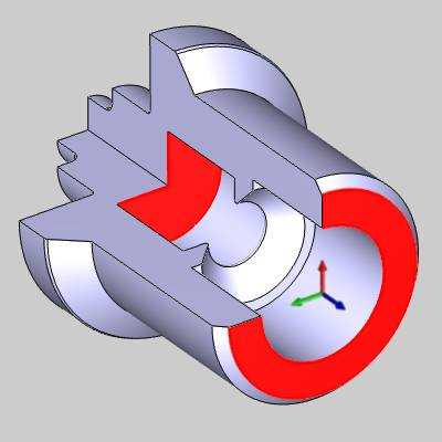

  • Face - Sets the feature to faces normal to Z+.
  • Back Face - Sets the feature to faces normal to Z-.

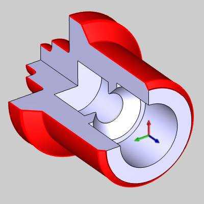

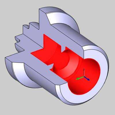

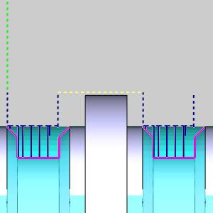

Region - Sets the features default settings for the type of toolpath being used. This will set the default rapids, entry and exits as well as default tool selection and direction of cut.
  • 1 - See examples.
  • 2 - See examples.

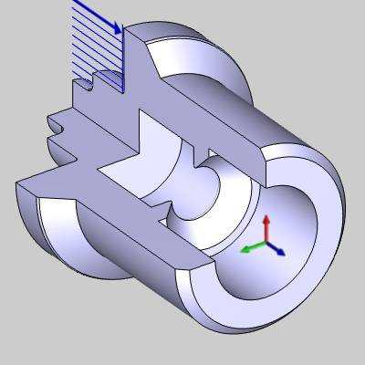

OD
OD Region 1
OD Region 2

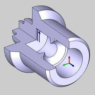

ID
ID Region 1
ID Region 2

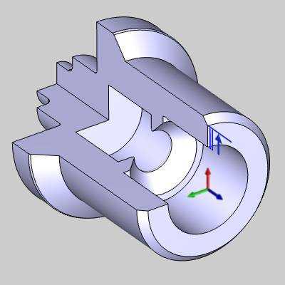

Face
Face Region 1
Face Region 2

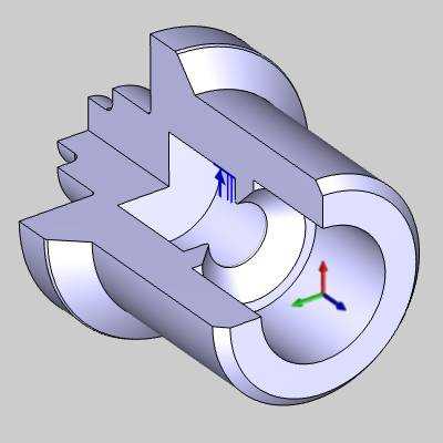

Back Face
Back Face Region 1
Back Face Region 2

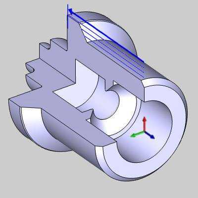

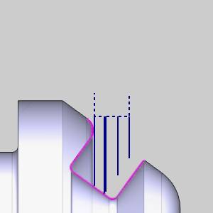

Rotate - Selecting this check box will give you the ability to rotate the feature so the toolpath is aligned with the geometry. This can be done with:
Lathe Feature
Rotated Lathe Feature
  • Angle - Type in the angle the feature is to be rotated.
  • Pick - Select pick to hide the Lathe Wizard and launch Pick Angle dialog in the Data-CAM Tree Manager.
    • Pick Wall - allows you to click an entity to set the toolpath parallel to. Clicking the entity once will add the geometry to the Selected Geometry list. Click OK to confirm.
    • Pick Floor - allows you to click an entity to set the toolpath perpendicular to. Clicking the entity once will add the geometry to the Selected Geometry list. Click OK to confirm.
