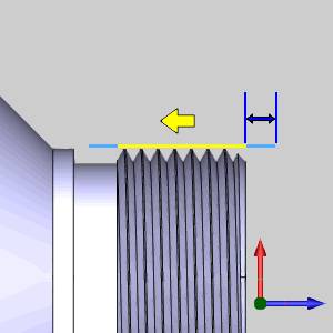

Lead-in
  • Lead-in - extends the beginning of the toolpath, into the thread, by the specified value.

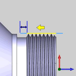

Lead-out
  • Lead-out - extends the end of the toolpath, out of the thread, by the specified value.
