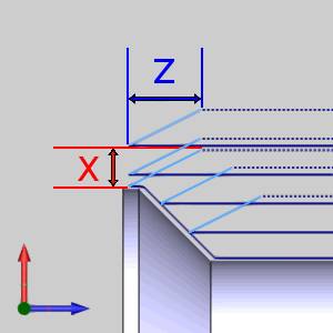

Lead-in
The Lead-in is an additional move prior to the initial cut into the material. The Lead-in allows you to specify how the cut is approached.
  • Parallel - creates a lead into the material that is parallel with the toolpath move it is preceding.
    • Length - determines the distance of the specified lead.
  • Perpendicular - creates a lead into the material that is perpendicular to the toolpath move it is preceding.
  • Horizontal - creates a lead into the material that is parallel to the center of rotation.
  • Vertical - creates a lead into the material that is perpendicular to the center rotation.
  • Angle - creates a lead into the material that is at a 45 degree angle.
  • Custom - creates a lead into the material that is dictated by the values entered in the Lead-in Z, and Lead-in X boxes.
    • Lead-in Z - sets the distance and direction of travel, in the Z-axis, for the approach into the toolpath.
    • Lead-in X - sets the distance and direction of travel, in the X-axis, for the approach into the toolpath.

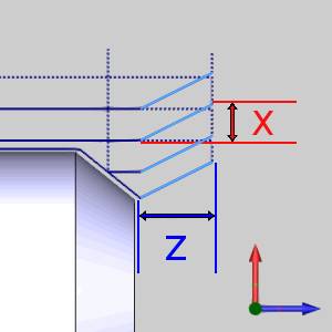

Lead-out
The Lead-out is an additional move following the last cut in the material. The Lead-out allows you to specify how the tool exits the cut.
  • Parallel - creates a lead out of the material that is parallel with the toolpath move preceding it.
  • Perpendicular - creates a lead out of the material that is perpendicular to the toolpath move preceding it.
  • Horizontal - creates a lead out of the material that is parallel to the center of rotation.
  • Vertical - creates a  lead out of the material that is perpendicular to the center rotation.
  • Angle - creates a lead out of the material that is at a 45 degree angle.
  • Custom - creates a lead out of the material that is dictated by the values entered in the Lead-out Z, and Lead-out X boxes.
    • Lead-out Z - sets the distance and direction of travel, in the Z-axis, for the approach into the toolpath.
    • Lead-out X - sets the distance and direction of travel, in the X-axis, for the approach into the toolpath.
