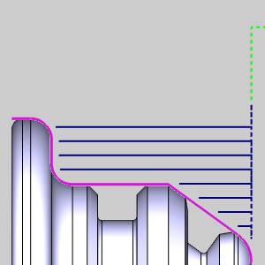

Patterns
Pattern

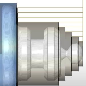

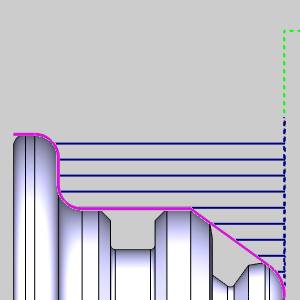

The Pattern allows  you to select how the passes are laid down.

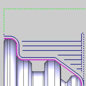

Standard - Each pass will be parallel to the center of rotation.
Offset - Each pass will be an offset copy of the selected geometry trimmed to the feature constraints.
Standard Offset

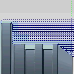

Sorting
Sorting allows  you to select how the passes link to the following pass.
Standard - defines a one-way cutting pattern with retracts between each cut.
Zig Zag - defines a two-way or alternating cutting pattern.

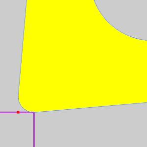

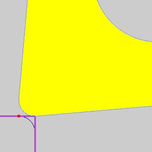

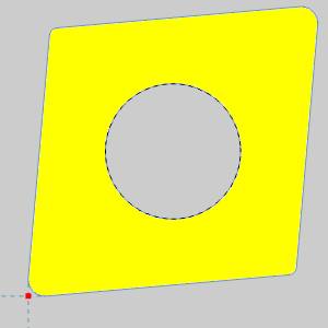

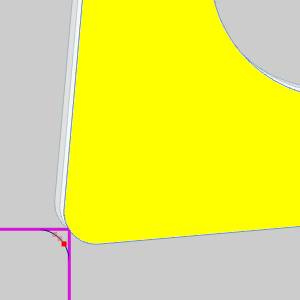

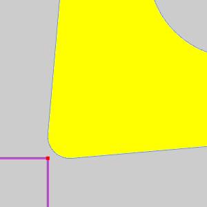

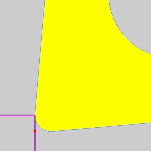

Each tool has a theoretical point placed on it as seen in red in the animation below. In the case of tools with a radius of any size, this point is not actually on the tool, but on the horizontal and vertical intersections of the radius. It is this point that the toolpath plots out.  When compensation is used, it is designed to place the actual tool and not just its theoretical point on the geometry. This can be accomplished with System Compensation, Machine Compensation, or a combination of the two.
  • System Compensation
    • Off - the selected geometry is used as the program path; Machine Compensation should be used.
    • On with Collision Detection - the system compensates for the tool nose radius and the insert geometry and avoids any detected collisions.
    • On without Collision Detection - the system compensates for the tool nose radius and the insert geometry without checking for collisions.

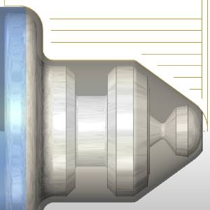

Depth of Cut - sets the spacing between toolpath passes.
Rough Allowance -  Selecting this option will create a pass before the final pass to act as a semi-finish. The spacing of the semi-finish pass will be dictated by the values entered in the Z and X boxes.

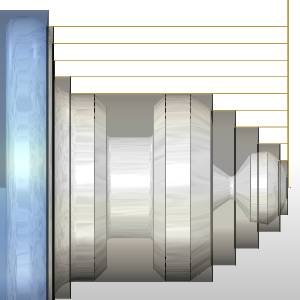

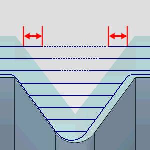

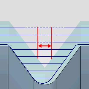

Overlap
The Overlap options allow you to create an additional move prior to the link to the next pass. This link will track back up the geometry in order to eliminate stair steps as seen in the images above. Overlap is controlled with either, To Previous Cut, No Overlap, or Custom Distance.
To Previous Cut - automatically tracks back up the geometry the distance of the selected depth of cut.
No Overlap - does not track back up the geometry at all.
Custom Distance - Allows you to enter a custom distance value. This value is a vertical distance. Entering the same value that has been entered for the depth of cut will track back to the last cut exactly.

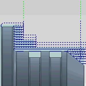

Corner Type
Round - keeps the specified tool geometry in contact with the geometry at all times.
Sharp - allows the tool to move off the geometry in order to line up with the next move on the following entity. This method eliminates the rounding over of the tool.
Theoretical Point on Tool
Rounded Corner
Sharp Corner
Bounds
Trim to Stock -  With this option selected, the toolpath that extends beyond the Operation Stock will be trimmed away.
