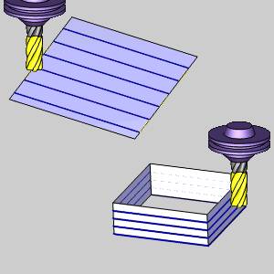

The Parallel Cuts feature creates a toolpath pattern with slices that are parallel to each other. The orientation of the slices are defined by two angles: Machining Angle in XY (which rotates the slices around the Z-axis) and Machining Angle in Z. The geometry selection only requires a drive surface/surfaces.

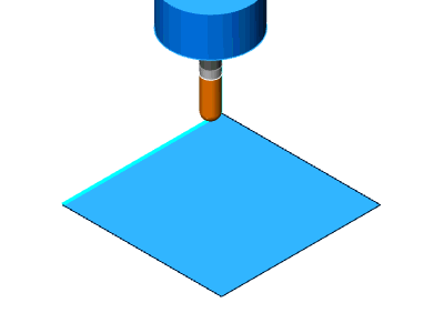

Cuts parallel to the Y-axis- XY angle = 0 degrees and Z angle = 90 degrees.

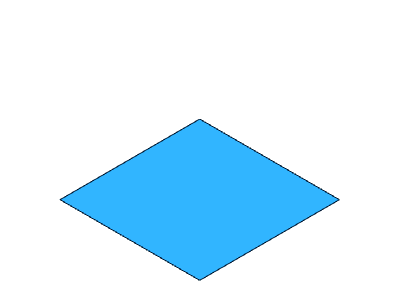

Cuts parallel to the X-axis - XY angle = 90 degrees and Z angle = 90 degrees.

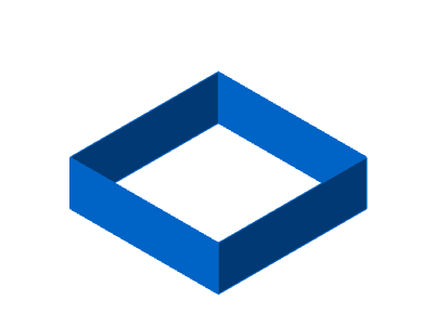

Constant Z Cuts - type a Machining Angle in Z of 0 degrees or select Constant Z. The Machining Angle in X,Y becomes unavailable.
