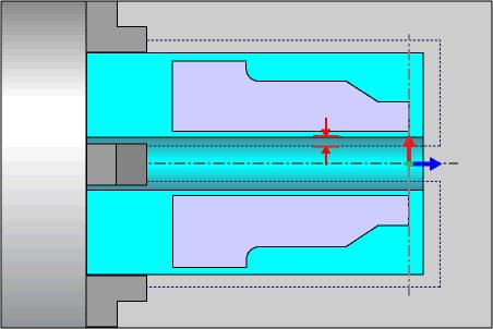

Stock Bounds
Automatically Detect the Stock Bounds
When the Auto check box is selected under Stock Bounds, the software automatically sets the four stock bounds parameter values for you based on the stock geometry that you define in the Stock Wizard and the machining origin that you define in the Machine Setup. You can click to clear the Auto check box to set the stock bounds parameters manually.
Important: The software automatically populates the Stock Bounds parameters in the Clearance dialog box for you based on the stock geometry and the machining origin. It is important that you properly define the machining origin location and orientation (axes directions) first, so that the software can populate the correct values for you in the Clearance dialog box.
Stock Bounds Parameters

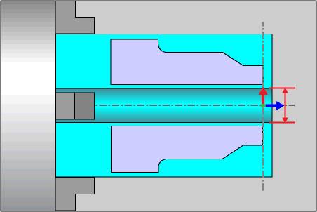

  • ClosedInternal Diameter - sets the inside diameter of the stock.

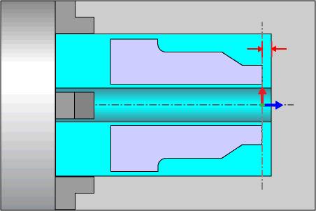

  • ClosedFace Z - defines the Z-axis value for the front face of the stock (from the machining origin).

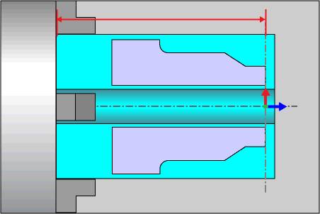

  • ClosedEnd of Stock Z - defines the Z-axis value for the back face of the stock (from the machining origin).
Clearance

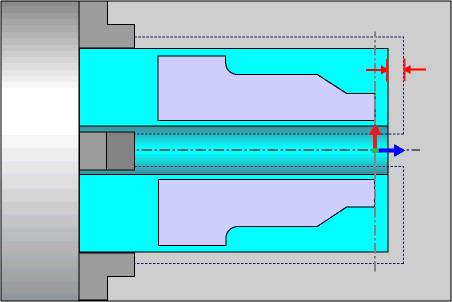

  • ClosedFace - sets the amount of clearance that is applied (in Z) for rapid movements along the stock face.

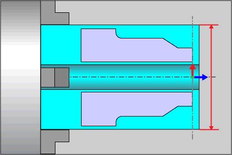

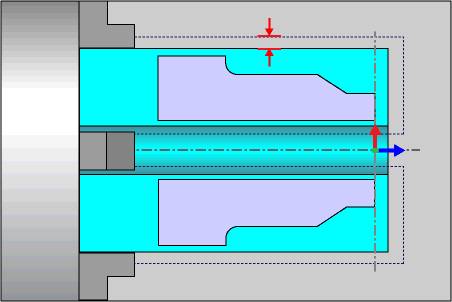

  • ClosedDiameter - sets the amount of clearance applied (in X) for rapid movements along the outside diameter of the stock.
  • ClosedInternal Diameter - sets the amount of clearance applied (in X) for rapid movements along the inside diameter of the stock.
