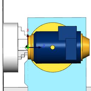

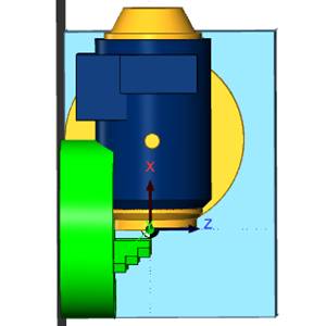

The rotation angle that you use for a milling spindle is based on where the machine controller defines zero degrees. The two most common zero degree orientations for a milling spindle on the machine are shown next.
Milling Spindle Zero
Degree Orientation (Z Axis)
Degree Orientation (X Axis)
