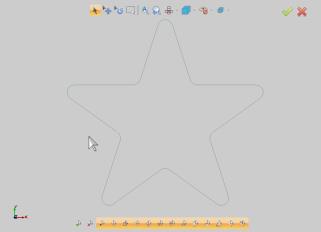

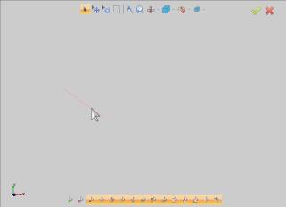

- With Selection Mode active, over hover the first line.
The line highlights. - Click the line to select it.

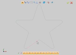

- Hover over the arc to highlight it.
The arc highlights. - Click the arc to select it.

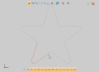

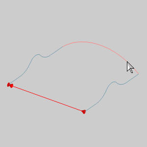

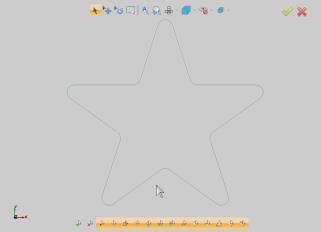

Chain Selection
Chain Selection: Direction

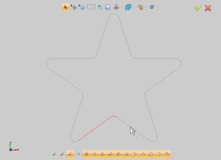

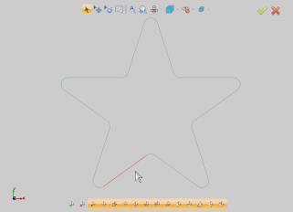

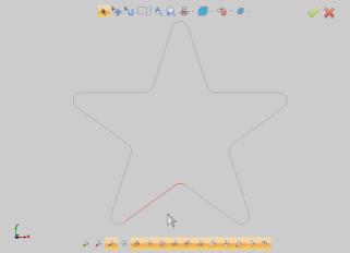

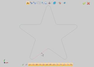

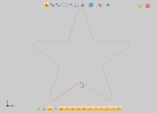

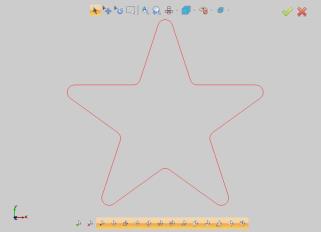

You can control the direction of your chain selection by choosing one side of the entity or the other. The chain will always pull from the back of the chain toward your mouse. In the example below you can see a simple chain made of five lines. You will notice, depending on which side of the center line we are on when we chain select will affect which lines are selected.
- Hover over the right side of the line, and hold Shift.
- With Shift still held down, click the line.
- Repeat the process to deselect the entities.
- Now hover over the left side of the line and hold Shift.
Note: In this section we see how we can control the entities that are selected with the direction of the chain selection. If the above example were a closed chain, like a square, the result would be the same regardless of the which side of the entity we were on. In some cases, you need to chain select a select portion of a closed chain. This is shown next.

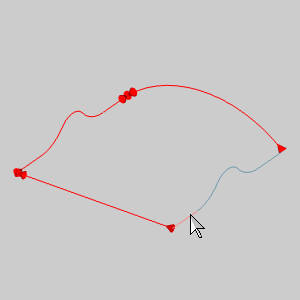

Chain Selections in the Picking Manager: Start and End

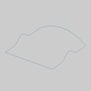

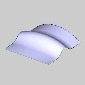

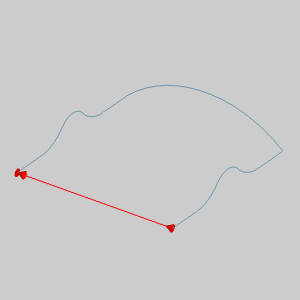

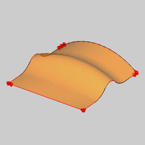

To demonstrate how to use the chain selection method to select a portion of a closed chain, we will use the Skin function to help illustrate the start and stop positions. This same method can be used outside of a CAD function, but when using many of the 3D CAD functions, the start and end points of the selected chain are shown with direction arrows which is ideal for this example. In the images below, you will see the wireframe entities we will use to make our surface.
The Picking Manager

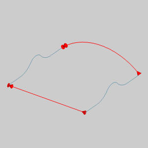

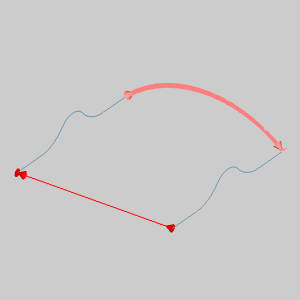

Part 1) Multi-Entity

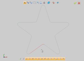

- Turn off Auto-Chaining and set the Mode to Multi-Entity.
- With focus on the Cross Section Curves list, hover over the left side of the line, and left-click.
The beginning of a chain is created. Selecting additional connected entities would extend this chain, but we will be creating a separate chain. - Hover over the right side of the arc on the opposite side, and left-click.
- In the Picking Manager, click End Chain.
Both chains are added to the Cross Section Curves list. - In the Cross Section Curves list, click Chain-2.
The chain highlights in the graphics area. - In the case of a Skin feature, we need these chains facing the same way, so click the
Reverse Direction button.
The chain is reversed. - Click in the Rail Curves list to give it focus.
- Window pick the entities seen in the image below.
- Click End Chain.
The chain is added to the list.

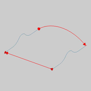

Part 2) Manual Chaining
While the Multi-Entity works in many situations, we will take a look at Manual Chaining as well.
- In the Mode group, select Manual Chaining.
- Select the end of the first entity in the chain we intend to create.
- Find the last entity in the chain, and click the end of it.
The start and end of the chain are connected. - Click End Chain.
The chain is added to the list, and the preview is shown. - Click OK.
The surface is created.

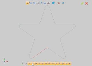

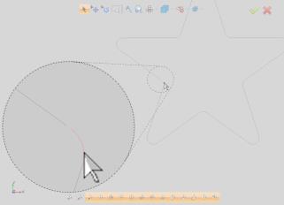

Chain Selection: Broken chains

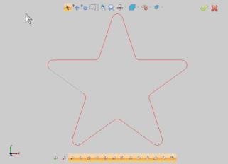

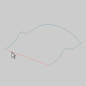

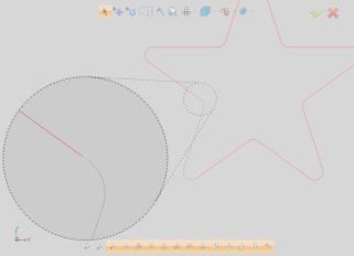

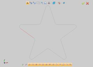

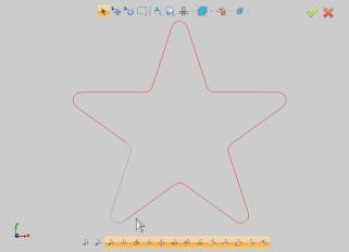

Occasionally, you may attempt to pick an entire chain, and notice only a portion of the chain selected. In this section, we will illustrate using chain selection to find issues with our geometry.
In this case, the full chain is not selected. - Repeat the process to deselect the entities.

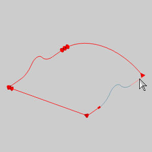

In this case, the full chain is not selected. - Zoom into the area where the selections stopped.
Notice there is a break in our chain.
Tip: Using the chain selection method is an excellent way to test your geometry to ensure there are no breaks, doubles, or unexpected intersections.

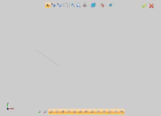

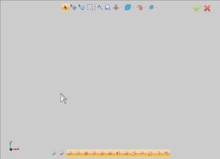

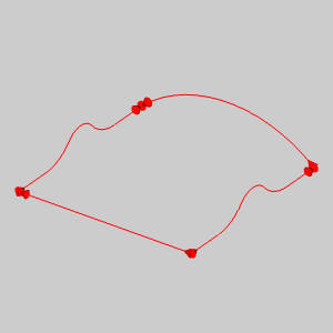

Chain Selection: Pro Tip 1

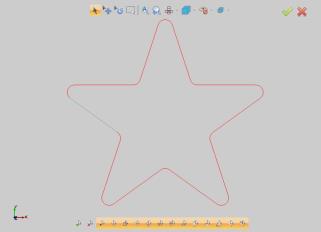

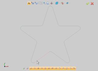

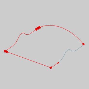

There may be times that chain selection produces seems as if a single entity was left out of the selection, as seen in the following image:
This can be due to a double entity created by mistake, or perhaps on a separate layer. However it is created, adding it to a feature can create issues. To correct the issue seen above:
- Window pick the entire selection.
When you release the mouse, everything that was selected will be deselected, and vice versa.
With our problem entity selected, simply hit delete.

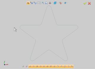

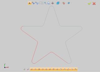

Chain Selection: Pro Tip 2

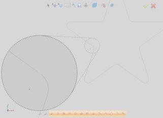

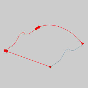

There may be times that chain selection looks perfect, but actually hides a double entity.
In the first pro tip, our double entity was clear. In some cases, they are not as easy to spot. Looking closely, at your selected geometry, you may notice the selection color of one entity is a little off. It may look as though it shares a little of the color of an unselected entity. If that happens its evidence of a double entity. To ensure you haven't accidentally left an entity that will give you trouble later, here is an easy way to test:
- With the entire chain selected, press Ctrl+X to cut the selected entities and place them on the clipboard to be pasted later.
- In this case we are left with an entity that should not be there.
Simply select the entities.
- With our problem entity selected, delete it.
- Now press Ctrl+V to paste our previously cut entities back into the graphics area.
Our clean chain is now, most definitely, the only thing left.
If there is no entity, you can immediately paste the geometry back, or use Undo.

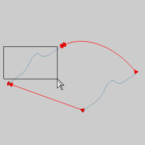

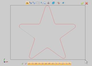

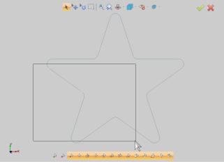

Window/Region Selection
While chain selection is the best way to make sure you have not selected any unintended entities, window selection is a quick way to select many entities, and even many chains, at the same time:
- In the graphics area, left-click and hold on one diagonal of the rectangle area you intend to select. In the image below, we use the top left corner.
- While holding down left-click, drag your mouse to the opposite corner, and then release left-click.
The area within the selection window is selected.

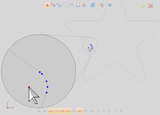

Snap Point Selection

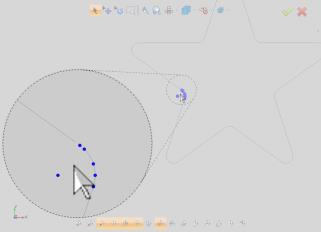

When placing items in the graphics area, you can utilize the snap point of other entities to place them where you intend. In the following steps we are attempting to place a point at the arc center of an existing radius:
- While in the Point function, hover over the arc for a moment and the possible snap points will appear.
Once the snap points appear, you can move your mouse away from the entity, and the snap points will remain until the snap points of another entity are activated, or the function is canceled. - Move to the desired snap point to highlight it.
- Click the snap point to place the point.
