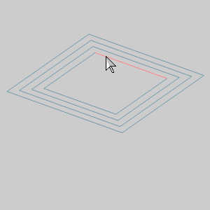

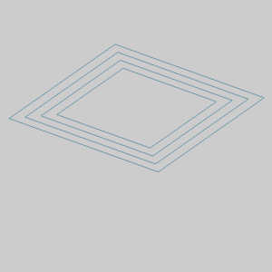

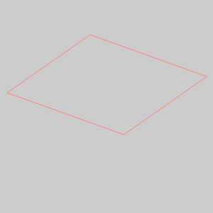

Step 1) Creating Entities
In the Shapes group, of the Create 2D ribbon, click
Rectangle.
The preview of a 2*2 square appears. -
Click OK.
The entities are created and a preview of the current rectangular parameters are still shown. -
Update the Length and Width of the Rectangle to 1.750.
The preview updates. -
Click OK.
Repeat this process to create another two rectangles with a length and width of:
1.500.
1.250.
Click Cancel.

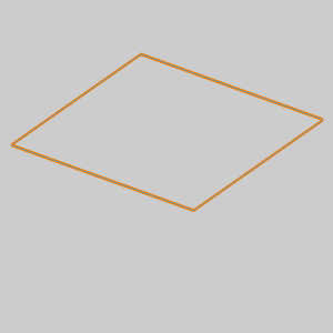

Step 2) Creating saved Selections

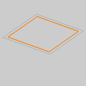

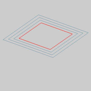

Enter selection mode, hover over one of the entities of the inner rectangle, hold Shift and Left-click to chain select all the entities.
In the Selections Manager, click
Save current selection.
The selection is saved in the Selections Manager as
Selection 1 (4). -
Selection 1 (4) to deselect the entities. -

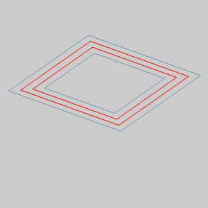

Repeat these steps to create a saved section for each rectangle starting with the next smallest and ending with the largest.

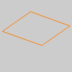

In the Selections Manager, select Selection 2 and Selection 3.
Click
Selection 5 (8). -
Right-click Selection 5 and select Rename.
The full name, Selection 5 (8), is highlighted for updating. -
Update the name to Channel and press Enter.
Notice the entity count is automatically added to the end of the name. -
Click Channel to deselect the geometry.

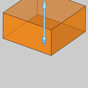

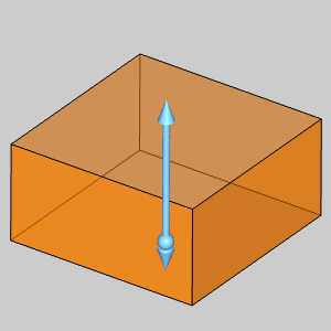

- In the Extrude group, of the Create 3D ribbon, click
Extrude Boss.

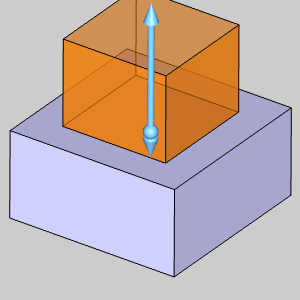

The Extrude Boss dialog opens in the Data Entry Manager. - In the Selections Manager, hover over Section 1.

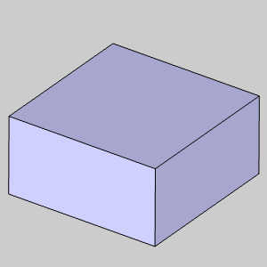

Notice the entities highlight even when they are hidden. - Click Selection 4 to add it to the Selected Geometry list.
Notice each of the saved entities is added to the list, and the preview appears. - In the Positive Direction group, set the Distance to 0.000 and press Tab.
The Distance is the Other Direction group is automatically set to 1.000.
- Click OK.

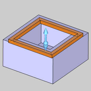

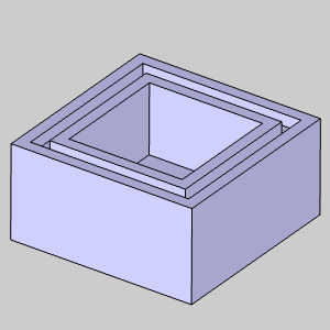

The boss is created. - In the Extrude group, of the Create 3D tab, click
Extrude Cut.

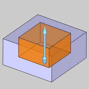

The dialog updates. - Click Selection 1 to add it to the Selected Geometry list.
The Distance is the Other Direction group is automatically set to 1.000. - Update the Other Direction Distance to 0.750.

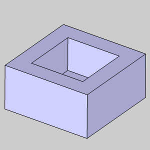

- Click OK.
The Extrude Cut is created. - Update the Other Direction Distance to 0.125.
- In the Selections Manager, select Channel (8).
The preview appears. - Click OK.
The Extrude Cut is created for the channel. - Click Cancel.
